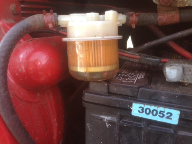

formariz 12,378 #41 Posted December 23, 2016 I had the same issues with a C125. Here what corrected it 100% from an earlier post. Posted November 28 · Report post On 10/30/2016 at 9:56 PM, Ed Kennell said: No need to rebuild a carb till this is resolved. Fill the tank to be sure the fuel level is above the fuel pump and try cranking again with the carb line off. These pumps have very little suction capacity. The pump intake must be below the fuel level. These tractors with the tank under the seat can have a fuel delivery problem if the pump is less than perfect. If the inlet valve does not seal perfectly, they will not suck fuel into the pump. Correct indeed! The stock mechanical pump in this system with tank under seat has a lot to work against it specifically gravity . With fuel tank full level is about even with pump, however as it lowers even with a new pump its hard work for it. On my c-125 anything less than full tank at full throttle under load there was always fuel starvation. It was also very easy to see what was happening by paying attention to the fuel level inside the clear inline fuel filter. Switched to a Faccet electric pump and tractor runs so much better. Starting it is pretty much instant, once it turns over it fires. Another change I made was to eliminate strainer inside tank. Somehow unlike other systems, with tank under seat, garbage always gets in the tank. Strainer gets blocked real easy and clearing it is just a pain. I opted to have an additional clear inline filter right outside tank. I can see how much debris is in it all the time and it is easy to change keeping tank also clean this way. So, I have a small clear inline filter outside tank, a filter right before pump (supplied with pump) and I also have a large clear inline filter in the engine bay. This last filter I found at Auto Zone and unlike most, fuel enters through top and also exits through top. Filter stands up straight acting like a sediment bowl. If there is water in the system it actually separates it from fuel and you can see water on bottom of it. All sounds a little excessive but for the last two years I never had to clean carburetor, adjust it or any other fuel related problem. 1 Share this post Link to post Share on other sites

tunahead72 2,633 #43 Posted December 23, 2016 5 minutes ago, formariz said: ... and I also have a large clear inline filter in the engine bay. This last filter I found at Auto Zone and unlike most, fuel enters through top and also exits through top. Filter stands up straight acting like a sediment bowl. If there is water in the system it actually separates it from fuel and you can see water on bottom of it... I'm curious about this last filter. Do you have a photo (maybe installed), or a part number from AutoZone? Share this post Link to post Share on other sites
formariz 12,378 #44 Posted December 23, 2016 1 hour ago, tunahead72 said: I'm curious about this last filter. Do you have a photo (maybe installed), or a part number from AutoZone? Don't have good access right now to tractor mentioned in post but here it is in another one. 1 Share this post Link to post Share on other sites
Warning:Unsupervised 83 #45 Posted December 23, 2016 Thanks' I like that filter too Formariz I may just get me one? My B100 8spd still starts the same after cleaning the pump so I figured when mine needs primed every week to use it I'll put a new one on it. May even put an electric pump on her this spring if it's too hard to prime, that gets old no doubt? Share this post Link to post Share on other sites
