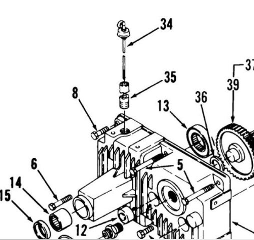

rmaynard 16,670 #6 Posted September 18, 2012 Here is a drawing of your transaxle with the dipstick. If it is not present, then maybe it has been removed and replaced with a plug, or you may have a plug with a dipstick attached to the underside. Share this post Link to post Share on other sites
bmrdoc 0 #7 Posted September 18, 2012 that is where the plug is.. Now call me crazy but I would think this is for differential fluid not trans fluid for the hydromatic. Is there a fill or check point seperate for hydro? Share this post Link to post Share on other sites

tommyg 154 #10 Posted September 19, 2012 It's very possible that the previous owner (PO) removed it for some reason. Perhaps the dipstick got lost and he needed to plug it somehow. The tube itself (#34 in Maynard's drawing) is really nothing but a piece of pipe similar to galvanized water pipe that threads into the tranny. That should be easy to rectify. It's the dipstick that might be a bit harder to come by. For the time being, if you would like, I could get some measurements so that you know how far into the tranny the dipstick goes to read "full". Then at least you could get an idea of your oil level. You can't think of your hydro system like an automobile. While there is indeed a differential, it's inside the tranny. Oil is moved through the tranny to the hydro motor to the valves and cylinders to the charge pump and back to the tranny again. (maybe not in that order). While a typical differential is a sealed unit with just a plug for filling and draining with oil that pretty much just sits there, on a hydro, the oil is more like the lifeblood of a circulatory system that carries "blood" (oil) to the organs and back to the "heart" (charge pump) again. BTW, that's about all I remember from college biology. :) Share this post Link to post Share on other sites
pfrederi 19,162 #11 Posted September 19, 2012 Until you get a dipstick just fill it to about 1" from the top of the trans axle case. Run it for a bit operate the hydraulics and check it again. Share this post Link to post Share on other sites
