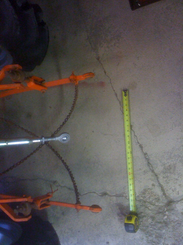

squonk 45,557 #1 Posted September 15, 2012 I'm not sure which forum to put this so it's going here. I'm working on a little project for my Power King and maybe a future Horse. Can any one with like a GT 14 or any Horse with a 3 pt hitch measure the spacing between the arms. I believe the PK has a "true Cat 0" set up and I'm not sure if the 3 pt. is the same. On the PK I measure 20" between the arms. Thanks, Mike Share this post Link to post Share on other sites
1maidenfan 202 #2 Posted September 15, 2012 My cat 0 hitch is 20" between the arms. D series wheel horse. Share this post Link to post Share on other sites

SALTYWRIGHT 861 #4 Posted September 15, 2012 I WILL CHECK MINE TOMORROW. BUT I THINK IT IS 20 INCHES ON MY GT-14. Share this post Link to post Share on other sites

KC9KAS 4,746 #9 Posted September 17, 2012 Yep on the 20" Read this... 3 Point Hitch Data.pdf Share this post Link to post Share on other sites
kpinnc 17,182 #10 Posted September 17, 2012 Same on the Bronco 14 in my avatar- 20 inches. Of course, the swivel ends can make that vary quite a bit. Share this post Link to post Share on other sites
Don1977 605 #11 Posted September 17, 2012 Here is a chart, you need a little more width to get over the pins. Share this post Link to post Share on other sites
