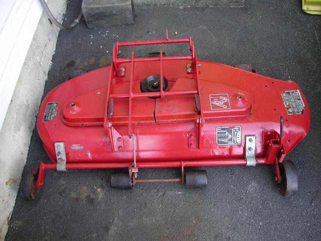

Addition >> the mower deck is a 42" side discharge. The reason for not locating any information is that the deck was at one time replaced with a somewhat newer deck. The deck has a "id" sticker that can not be read. The newer deck has different spindles as opposed to the older deck but they look very much alike except for that. I will post a picture of the deck, maybe someone can identify it by the picture and offer some advise. I searched the Toro site as best I could , but found nothing helpful there.

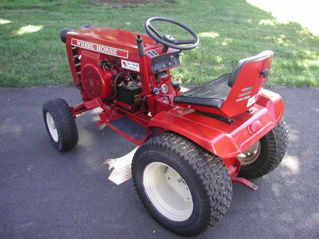

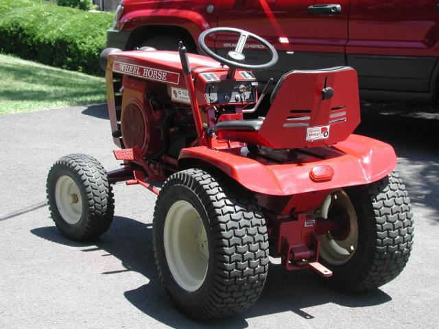

The pics show the tractor after having been cleaned up and polished, the wheels were painted as well as the brake and clutch pedals. The mower deck was in not so good a condition, I gave it a coat of spray paint until I can locate another. The numbers on the id tag were gone, faded.

Drive belt 7473 for the tractor. It's best to buy the original belts they just last longer and give less trouble. As for the mower base you need to give the size and model no. so some one can give you the right numbers. There are a few different mower bases that can be used on that tractor. If you can't find the model no. pictures of the base will be a big help.

wigglinpins Nice looking tactor, and Welcome to Redsquare!

Great looking mower, even in fear of gettin' run off from her : is your deck guard/cover manufutured split if can tell?
Is center pulley big on top little below or same size or little top big bottom Are spindle shafts top and blade double d or keyed top and round bottom?
Lokked at: 75-42ms01, showed full cover, double d spindle t/b, center pulley same dia t/b, no sep chute
85-42ms01, showed c cut out front full cover, keyed spindle, ctr pulley little t-big bottom and separate discharge chute
95-42ms01, split cover not cut notch, keyed spindle, ctr pulley big top little bottom and separate discharge chute
If this is any help identifying come back: 65,75, 85, and 95-42... all showed 102742 mower drive belt replaced by: toro Consumer #94-2501,75 and 95 had same mower drv belt #1594, 85 mower drv belt #6738, 65 didn' list but mine is a 65 with reads "replaces W...H... 102742" (1/2" x 130)

Then you'd prob still be best guess. Also relooked at pulley part #'s on center pulley for 65, 75 same # diff picture, 85, 95 same # diff picture. Don't know what IPB they are using, so spindle for 75 can not be double d. I guess I lucked on all my stuff! Still all you can report will get someone who knows positively!
