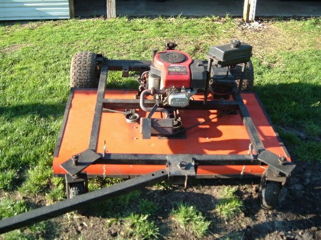

546cowboy 302 #9 Posted September 8, 2012 Really the way to mow it faster is with a trail mower pulled behind. When I first decided to pull one behind a 42" deck I figured I would have problems going between trees and around bushes and stuff. Not True! If you get a 44" you can go pretty much any where with it. I used to pull my home built 60" behind an old Cub just fine. At one time I had the 42" deck, the 60" trail mower and a 44" trail mower all hooked together and mowed an acre and a half pasture in 35 minutes. That used to take me 3 1/2 hours with just a 42" deck. If you look around you can find those 44" ones on CL or ebay pretty cheap compared to a new one. Here is my home-built mower. :WRS: Share this post Link to post Share on other sites
