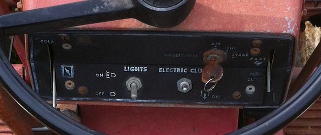

MR49 20 #3 Posted September 4, 2012 Well I was trying just to use the stuff that was on it. lol. I need to get a few things, such as new points, condenser, plug, carb kit and gasket kit. Oh and filter too. Im pretty sure that the dash is off of a b-80. But im not sure. And i did soak the carb and all the mess that fallows. Im not sure on the carb to engine gasket ill check that. Ill try the origional settings again too. I think I set them wrong. Thanks alot! Ill get back to ya if i get anything figured out. Share this post Link to post Share on other sites
