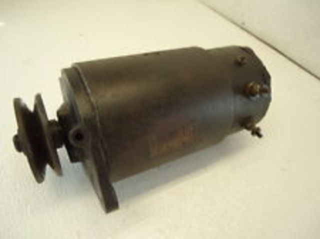

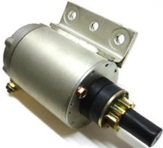

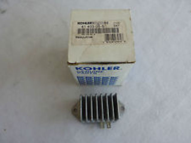

rmaynard 16,451 #5 Posted September 3, 2012 The second issue is that I believe either the starter/generator relay is getting bad or the electrical rectifier/converter is going bad. I just purchase a new battery for it and every so often I'll shut off the mower after a half hour or so of use and the battery is drained. Haven't really busted my rear to trouble shoot this but I'm assuming its either the relay or the rectifier/converter? First of all, if you have a starter/generator, you don't have a B-100. However, you said that you have a rectifier/converter. Did you mean regulator/rectifier? If so, you don't have a starter/generator and then you might have a B-100. Does your starter look like this or this Does the "rectifier/converter" look like this or this In any case, if the ignition switch is defective, that can cause a battery drain issue. Troubleshooting is simple on most tractors, but first we have to establish what we are dealing with. Share this post Link to post Share on other sites
guitardude 6 #6 Posted September 3, 2012 Maynard, my starter looks like the second one (but mine is red and dirty - see pics...LOL) and my regulator/rectifier is like the second one with the cooling fins. The mower has a 10 HP Kohler engine, the Model is 1 0510 9 and the serial number is 1024438 (see pic). 608KEB, I'm assuming that you're saying that I should be able to touch the belts together when the "belt drive clutch" IS disengaged? Thanks! Share this post Link to post Share on other sites
rmaynard 16,451 #7 Posted September 3, 2012 You have a 1974 B-100 Automatic. If the solenoid (as pictured) clicks, and the starter turns over and starts the tractor, it appears that the solenoid is probably okay. As far as the drained battery is concerned, I would try this. Do you have a volt meter or multi-meter. If so, check to see if you still have 12 volts between ground and the (+) connection on the ignition coil with the ignition switch turned off. If you do, that is probably where the battery drain is coming from, and you should replace the ignition switch. If not, then there are other places and things that might be draining the battery as well. There is a thread in the electrical section on how to find a "parasitic battery drain". It involves using the ammeter portion of your multi-meter and using the process of elimination to find what is drawing current. Do a search using the term "locating parasitic battery drain" and you will find the thread. 1 Share this post Link to post Share on other sites

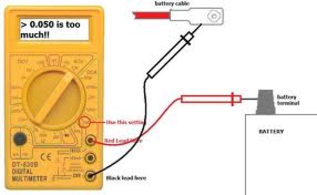

Cole 25 #8 Posted September 3, 2012 im assuming that you have the 10 or 15 amp charging system, you can do the test to see if the regulator and stator is in proper working order. the service manual link is under at the bottom of this post. the testing section is on pages 82-84 in the manual, now the parasitic draw test is performed by removing the negative cable from the battery, now set your multimeter or DVOM on the 10 amp scale and put the red cable on the tester into the 10 amp scale port and make sure every thing is shut off (headlights, ignition switch, etc.) hook one lead on the tester to the negative post on the battery and the ther lead on the negative cable. now during this test if the multimeter shows less than .5 amps you have no draw and then the charging system or ignition switch is faulty. i will post a pic of how to setup your mulitmeter, if you dont have a multimeter you can purchase a cheapo at wally world or harbor freight tools for under $10. hope this isnt too confusing and helps, maybe save old iron will come in and clear this up for you. make sure you do the parasitic draw test first to save time. link to service manual pages 8.12-8.14 http://www.wheelhors...le/1839-kohler- k91141161181241301321341/ how to setup your multimeter or DVOM Share this post Link to post Share on other sites

guitardude 6 #10 Posted October 29, 2012 Hi everybody! I just wanted to thank you ALL again for your help, and give you an update on my Wheel Horse adventures. I finally narrowed down the problem to the "Voltage Regulator" of which I had sort of suspected in the beginning. So, I went to a local "small engine" shop and the guy was VERY familiar with Wheel Horse products and indicated that he didn't have the voltage regulator but could get me one. He ordered the part, I went and picked it up and then installed it last week. I was a little surprised as that darn voltage regulator was $135. However, its already paid for its self as I've been pulling my leaf brush with it several times already. Seems to work like new and no issues of battery drainage or not starting. Thanks again for ALL your help. Just about time to put the plow on the front for winter........yuck, I sure miss Georgia. David 1 Share this post Link to post Share on other sites
