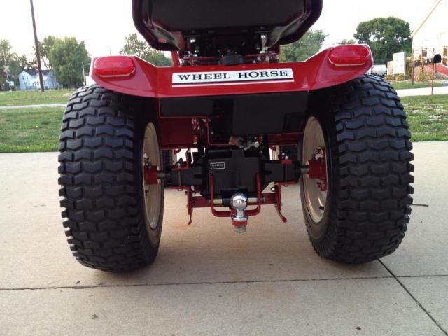

Martin 2,133 #4 Posted August 29, 2012 without getting into it too much, i think from the ipl's below you can see how they mount....... looks like they changed style around 1968..... Blade_Dozer_42in_1968_6-2111_Formerly_BD-4267.pdf Blade_Dozer_42in_1968_6-4111.pdf ive been told that the angle on the top left side of the bracket in this pic is for the tiller to attach in some way.... this is on my c125.... Share this post Link to post Share on other sites
Kelly 1,038 #5 Posted August 29, 2012 That is the old style snow blade mount, it will not work with the newer blades, it is wider and mounts on the outside of the plow frame, it does mount in front of the axle, the later ones are like the one Martin posted, the angle iron for the top plte on the left side has a hole near the rear, that is where the spring for spring asist goes if you have the spring, it is not needed with hyd. lift. Share this post Link to post Share on other sites
