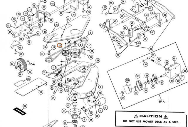

I am assuming that your deck is a 5-0721. In that case, the pulleys are as follows:
Pulley, flat idler, 104975. (#101)
Pulley, idler, 112426 (#25)
Pulley, center drive, 99-5357 (#7)
Pulley, V-idler, 92-7103 (#97)
Pulley, right & left, 105781 (#9)
The parts page would not pull up a diagram, so the parts list had those pulleys listed.
I will try to find a diagram.

I don't know if this is your deck, but it should be similar. Take a look at the pulley that you need and reference the item number. Then look at my post above. I have added those item numbers.
