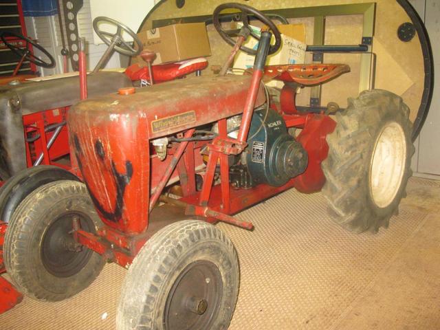

hcminis 1,762 #1 Posted August 22, 2012 Was able to snag this 753 from C.L. this week. Complete and in pretty good shape. Was able to get good spark. Motor will turn over pretty good. Carburetor throttle shaft is siezed and broke. So, gonna need a new carburetor...hint hint and help locating one. Came with the rear bracket for a snow plow which is a plus. Back rest is in pretty good shape considering the age. Really excited about this one. Hope to get it running soon. Sorry for the bad pictures. Hope to get better pics this weekend. 1 Share this post Link to post Share on other sites
Tankman 3,528 #2 Posted August 22, 2012 Nice find! What's on the front of the hood/grill? Share this post Link to post Share on other sites
hcminis 1,762 #3 Posted August 22, 2012 Previous owner fabricated a light and bracket. Good thing he used the factory holes in the frame to mount the bracket. It is gone now...lol Share this post Link to post Share on other sites

Tankman 3,528 #5 Posted August 22, 2012 Backrest looks like an easy fabrication. In the shop, easy to form. Guess one could form a piece of left over leaf spring? Share this post Link to post Share on other sites

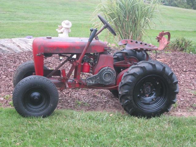

hcminis 1,762 #14 Posted August 23, 2012 Here are a couple more pictures with better light. 2 Share this post Link to post Share on other sites

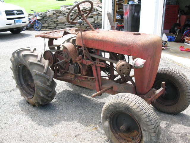

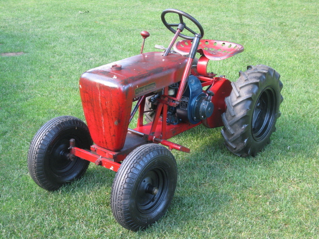

stevebo-(Moderator) 8,604 #15 Posted August 24, 2012 Since I have "some" experience in oiling up my tractors lol .. you will want to clean it first using simple green and a scotchbrite pad to remove all grease and surface rust so it is then smooth. Allow it to dry and then you can simply pour oil on a decent quality rag and wipe it down. Other ways to do it are to use wd-40 by spray and allow it to soak for a bit then wipe the excess off. What I have recently been using is marvil mystery oil poured in a spray bottle and then spray it on. By using the spray you can get it in areas that you will not be able to with a rag. I allow it to soak for a bit then wipe off the excess with a rag. Here are some examples of the oiled method... Share this post Link to post Share on other sites
