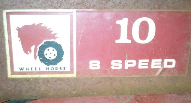

Toad454 0 #1 Posted August 22, 2012 My 10when I try to start it it wont stay running on just run I have to turn the key to run acc or it will just die any idies Share this post Link to post Share on other sites
Save Old Iron 1,573 #2 Posted August 22, 2012 Toadie, 10 what ? What model ? Kohler points engine / Tecky solid state / Chicom replacement ?? Share this post Link to post Share on other sites
rmaynard 16,991 #3 Posted August 22, 2012 Sounds like a bad ignition switch to me. Share this post Link to post Share on other sites
Kelly 1,038 #4 Posted August 22, 2012 Did it run before?? have you done anything to maybe make it not start? could be a few things, but I think Bob is right probably ign. switch. Share this post Link to post Share on other sites
Toad454 0 #5 Posted August 22, 2012 This is what the plate say 103608 Share this post Link to post Share on other sites
Save Old Iron 1,573 #6 Posted August 22, 2012 1973 no name 10 / 8 speed. No serious wiring modifications? Kohler points / coil engine ? Check for correct switch for a points / coil system then loose/ corroded wiring / connector, etc then investigate the igntion switch. Share this post Link to post Share on other sites
Toad454 0 #7 Posted August 22, 2012 It has a 10hp kohler points and will fire 3or4 times but in that time you have to turn the key to run acc or it wont stay at idile but it wont rev up ether Share this post Link to post Share on other sites
Toad454 0 #8 Posted August 22, 2012 What do you mean by no name? Share this post Link to post Share on other sites
rmaynard 16,991 #9 Posted August 22, 2012 That series of tractors had no name, just a number representing the horse power, and what kind of transmission. So yours is a 10 8-Speed, unlike the 1974 10 HP which was called the B-100, or the 1972 10 HP which was named Raider 10 or Charger 10. Share this post Link to post Share on other sites
kpinnc 17,499 #10 Posted August 22, 2012 Tractors made that particular year did not have names like "Raider 10" or "B-100". That was during the AMC aquisition of Wheel Horse, so the tractors just got tagged with a description instead of a traditional name. It's not a derogatory remark nor did it affect how tough the tractors were. "No name" is just a nickname for tractors of the period given by many collectors. EDIT: Bob beat me to it. Share this post Link to post Share on other sites
