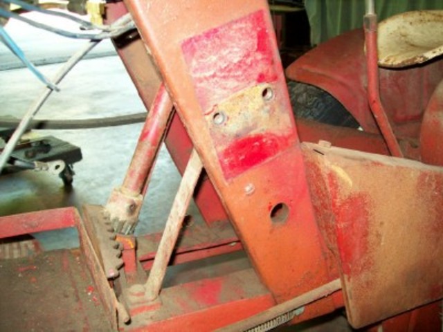

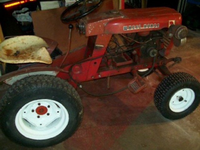

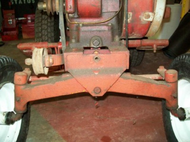

tzthompson 2 #1 Posted August 20, 2012 I got this one recently and it appears to be a mixture of several models. It has a front axle like my 753 I am working on. It was advertised as an 854 and came with an 854 belt guard which was not on the tractor but had a 502 guard on it. The engine is a 7hp K161 manufactured for Tri-powered corp which built gas powered golf carts in the early 1960s so I know that has been changed. It came with a complete HY-2 hydraulic system with the ignition box mounted on the side of the tower. The tower, dash, lift and gas tank I believe are 702 or other 1962 models. The battery tray is a bolt on with studs sticking out. It doesn't really look like the tower has been changed out. It has 5 bolt hubs but they have yellow paint under the red which lead me to believe they may have been changed. I love the forum and would like some of your thoughts on it. I am just trying to decide what direction to go with it. Thanks!! Share this post Link to post Share on other sites
CasualObserver 3,411 #2 Posted August 20, 2012 Yellow paint is a common anomaly that has never been figured out. It has shown up in multiple years, and has no explanation, because it's pretty commonly accepted that WH didn't prime anything. You have some on the frame under your battery tray too. You've pretty much nailed all the details though. You have a mutt built from at least two round hoods. I'd guess since you have 502 parts and it was listed as an 854... it's probably those two. How long is the hood? I would say your dash tower had to have been changed out at some point though, whether it looks like it or not. Probably a long time ago, so they've aged together. Looks like there was a snowblower on this tractor at some point... that bracket and pulley bolted to the frame on the front right was part of it. If you don't want it... sell it. People are always looking for that because they're usually lost because they stayed with the tractor.... not with the snowblower, and they don't always get sold together. Share this post Link to post Share on other sites

stevasaurus 23,296 #8 Posted August 20, 2012 I think it does look like the 702 dash, and you are right about those 5 bolt hubs not being correct. I like the looks of the horse though, it looks to be in good shape. :) Share this post Link to post Share on other sites

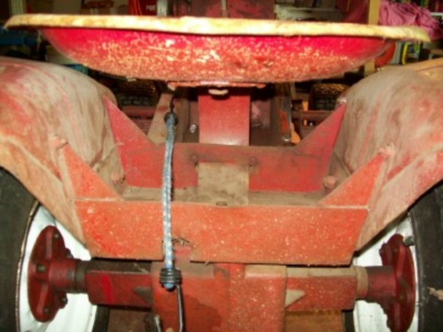

CasualObserver 3,411 #9 Posted August 20, 2012 The 5 bolt hubs are correct if that rear end is from an 854. As for whether they mixed parts, not really. They stayed pretty true to model changeovers. They had to... otherwise parts lists wouldn't match production. They did "update" parts though as things went along. These were generally alerted in a service bulletin, but not always. Share this post Link to post Share on other sites
octfst 378 #10 Posted August 20, 2012 The dash is 854 a 702 would be similar to a 701 you said the front axle was like a 753 the 854 would be the same 702 would be similar to a 701. the only diff between a 502 & 702 is the motor. Share this post Link to post Share on other sites

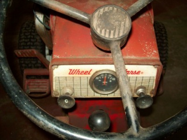

TT-(Moderator) 1,162 #11 Posted August 20, 2012 An 854 has a two-piece tank (removable bottom) and the dash decal is chrome and black. A 702 would have the one-piece tank with the bolt-on cast iron dash panel and the decal like pictured above. (a 701 has a one-piece tank with the off-white bolt-on plastic dash panel) Beyond the obvious engine difference, a 702 also has a starter button, amp gauge vs. the hole plug with toggle switch, and a battery vs. an open top storage/tool box - if it's still there. The serial number / shift pattern sticker normally covers the starter button hole on the 502 (and 633) since the hole is not used. The ammeter in the tractor above is not original and I see no sign of the serial number / shift pattern sticker, so it very well could be a 502 "body" on an 854 chassis. Share this post Link to post Share on other sites

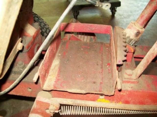

tzthompson 2 #14 Posted August 21, 2012 Is the bolt-on battery tray with the studs consistent with the 854? There are no decals regarding shift pattern or serial number. It does have the bolt-on cast iron dash and one piece gas tank as mentioned above. Tim Share this post Link to post Share on other sites
TT-(Moderator) 1,162 #15 Posted August 21, 2012 The bolt-on battery tray is correct for an 854 ~ necessary because of the lower steering shaft change. (tie rod attachment plate was plain steel and welded to the front of the shaft in 1964 vs. the cast iron part that was pinned to the shaft & used in 1963) Share this post Link to post Share on other sites
tzthompson 2 #16 Posted August 21, 2012 It does have the plain steel tie rod attachment plate and it is welded to the shaft. When looking at the tower, I can see where it did have a starter button mounted at some time. When I got it, it had the ignition mounting box attached to the left side of the tower to allow the HY-2. Then based on what you said Terry, I guess my mutt probably had an 854 daddy and a 702 mommy. Thanks for all the comments and information!! Tim Share this post Link to post Share on other sites
