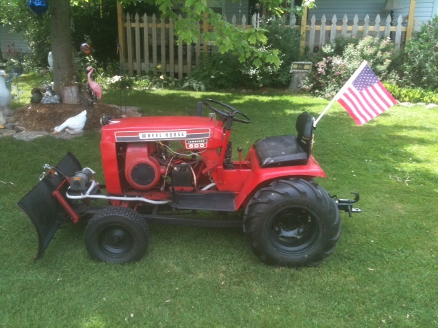

OK THANKS....BY THE WAY NICE PROFILE PIC
c161rat
Thanks.....Thats my C161 rat wit a couple mods and a custom paint job....
c161rat
Here is a link to the build...... for your viewing pleasure...LOL
