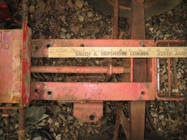

rmaynard 16,877 #4 Posted July 22, 2012 I have a naked B-80 4-speed frame, and only one hole lines up with any of the engine mounting holes on my K301, the tab hole nearest the drain tube on the flywheel side. There are no holes even close to the 10-1/2" oil pan holes, and no hole for the front tab on the flywheel side. Picture coming. Actually, I was looking at the wrong holes. I put a battery holder in place and found that there are holes that might line up, but it would put the engine too close to the front. Share this post Link to post Share on other sites

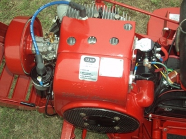

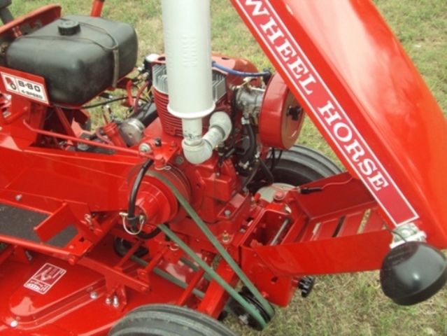

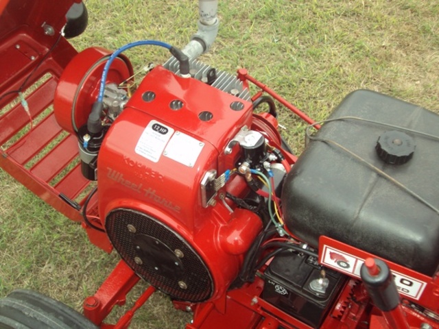

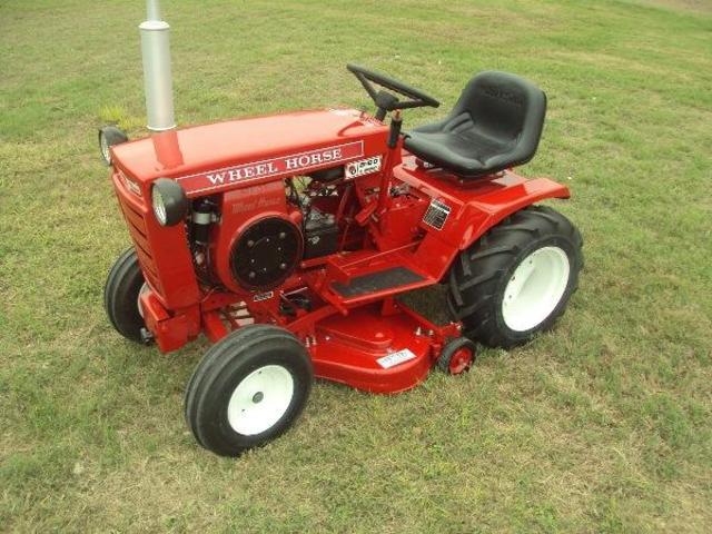

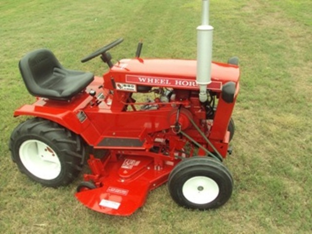

bowtiebutler956 650 #6 Posted July 22, 2012 My 74 B-80 has a K301 on it, and it fits great. I got it with this engine already on it, but here are some pics. Matt :flags-texas: Share this post Link to post Share on other sites

bowtiebutler956 650 #9 Posted July 22, 2012 Matt, you're missing a mule drive cover...lol! I'll put one on there one of these days. I'm very suprised nobody has commented on my Craftsman seat. Did I just say that? Oops. Matt :flags-texas: Share this post Link to post Share on other sites
Tankman 3,528 #10 Posted July 23, 2012 Besides the seat, are the headlamps stock? Nice Horse! Very nice including the seat 'n lighting. Share this post Link to post Share on other sites
