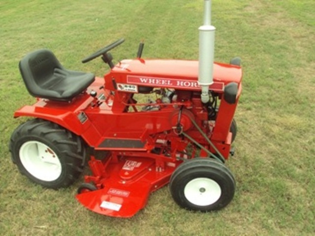

bowtiebutler956 650 #10 Posted August 5, 2012 I'm a lover of stacks myself. Matt :flags-texas: 1 Share this post Link to post Share on other sites
darg 7 #11 Posted August 5, 2012 bowtie, is that your C160? Exhaust looks about loke mine. Nice looking tractor. I haven,t figuared out how to post a picture of mine on the form yet. darg Share this post Link to post Share on other sites
JamesBe1 84 #12 Posted August 5, 2012 I am a fan of stacks too. Be sure to use a rain cap. Besides keeping rain out if you happen to park it in the rain, it keeps small critters from building nests in there. 1 Share this post Link to post Share on other sites
bowtiebutler956 650 #13 Posted August 5, 2012 bowtie, is that your C160? Exhaust looks about loke mine. Nice looking tractor. I haven,t figuared out how to post a picture of mine on the form yet. darg Yes its mine, but its not a c-160, its a B-80 with a larger K-301 12hp Kohler on it. Matt :flags-texas: Share this post Link to post Share on other sites

elicountryboy1996 2 #16 Posted September 3, 2016 On 8/4/2012 at 8:47 PM, bowtiebutler956 said: I'm a lover of stacks myself. Matt What all parts do you need to make a exhaust system like is on your wheel horse? I want a side stack as well on mine Share this post Link to post Share on other sites
