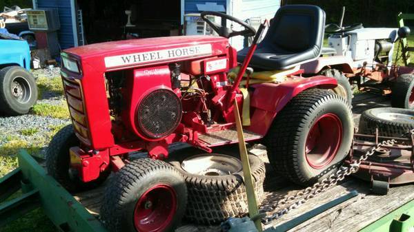

freeisforme 3 #27 Posted July 26, 2012 The whole B-80 deal took another twist yesterday, my neighbor came by and noticed I had a complete 12hp sitting on the bench, he apparently liked the 12hp better, so we traded. My old 12hp for the just rebuilt 14hp that he had on it in the first place. I notice in reinstalling the 14hp that the right, forward outermost bolt hole hangs over the frame. Is the accepted method here to just leave in unused or use a J bolt of some type? I also thought about making a small angle iron frame extension to reach out to that hole. How did the 14hp or any larger motor mount in those models that came factory with a larger motor? Was the frame different or just modified in some way? Share this post Link to post Share on other sites
rmaynard 17,659 #28 Posted July 26, 2012 Something sounds a little screwy to me. Why would he want a 12HP over a 14hp? The bolts on the flywheel side go through the holes in the tabs on the pan, then through the frame. The bolts on the PTO side come up through the frame and into threaded holes in the bottom of the pan. The holes in the tabs on the PTO side of the pan are not used. Share this post Link to post Share on other sites
freeisforme 3 #29 Posted July 26, 2012 He wanted the 12hp because it already had a flywheel drive set up, the tractor he needs it for drives only off the flywheel. The 12hp runs, it just need a good going over. I give up trying to figure him out. If it were me I'd have just swapped flywheel screens and added the drive adapter to the 14hp, but he wanted the 12hp since it's what his other machine came with. The 14hp is back in the WH now, basically just as it was when this whole deal began. My take is that it never had all four bolts in the motor, I put the motor back in the same spot where it was and only three holes line up. I don't see a hole to match up to the right front hole, either from below the frame into the pan or to the outer tab. The other three bolts are in tabs. The two on the flywheel side are in holes in the frame, the right rear goes through a bracket on the out side edge of the frame. The motor hangs over the frame about 1.5" or so. Share this post Link to post Share on other sites
rmaynard 17,659 #30 Posted July 26, 2012 A standard large oil pan, when properly mounted, will have the outside edge of the PTO side tabs projecting 3/4" from the frame Share this post Link to post Share on other sites
freeisforme 3 #31 Posted July 26, 2012 That's about how much hangs over the frame. I removed the right rear tab, it looks like it was added and found the bolt holes to fit the holes in the underside of the pan. I think it may have been mounted wrong before since the paint witness marks are all farther rearward than where the motor sits now. It also fits the belt guards better. The 8hp looks to have sat bolted down to all four corner tabs on the motor. The pan for the 14hp is quite a bit larger. It looks like I need a longer throttle and choke cable, the way he had them run before they both ran right across the face of the fan shroud, he had tape over where they had rubbed through. The choke cable is way too short and the only way to make it work sets up the choke to work backwards. Up is off, down is choke on, opposite of how the dash is marked. When running without the deck, does the belt and mule drive stay on the tractor? Share this post Link to post Share on other sites

freeisforme 3 #36 Posted July 28, 2012 I found a few pics in the gallery section of a tiller set up. There's a guy locally that's selling a tiller but he don't have or won't sell the adapter pulley parts with it. He wants $100 for the tiller, but its worthless to me without the whole set up. There's another tiller for sale that comes with a GT-2500 tractor, but the motor is bad. The seller said the motor don't have enough compression left to run. Its got a rear tiller and a snow plow with it, but the tractor itself looks smaller than my B-80? Will a tiller and plow off a GT 2500 fit my B-80? Share this post Link to post Share on other sites
Trouty56 568 #37 Posted July 28, 2012 I think there is a member who could build one of those idlers for you for a decent price or there is a guy on ebay that makes them. I'd think twice about the 100 dollar tiller especially if you can see it and it is in good shape.... Most go for a couple hundred dollars at least. Here's a cool thread by one of the great fabricators on the forum...... Share this post Link to post Share on other sites
freeisforme 3 #38 Posted July 29, 2012 By the looks of it I could make one too. It looks time consuming making the latch parts but the rest don't look too hard. It would be easier if I had one to copy. The guy with the tiller never used it, he bought it with a parts machine but never had the pulley adapter. Is a tiller off a GT 2500 the same? That tractor has an aluminum Briggs engine. Its a bit of a drive but I can buy that whole machine with the tiller and drive complete for cheap. It just sounds like a smaller machine to me, if I knew the tiller and drive was the same I'd make the drive and go get it. (Its about a 3 hour round trip ride, probably about $40 in gas pulling a trailer up and back). If it won't fit its not worth the drive. Share this post Link to post Share on other sites
Trouty56 568 #39 Posted July 29, 2012 It probably will work. The GT 2600 looks to be about the same tractor frame with a side PTO. It probably has the rear attach device you will need also. You have some spare parts then too.... Share this post Link to post Share on other sites
freeisforme 3 #40 Posted July 29, 2012 It looks a lot like the B-80 but uses an aluminum Briggs motor. I'm not sure if the frame is the same or not? Its 4 or so years newer, but still in that same time frame, so I guess its possible they just built a cheaper series with aluminum Briggs motors? I haven't seen it yet, all I know is what I found online about the 2500 model, but without having the two side by side its hard to judge size. I wasn't sure if the 'GT' series wasn't a completely different tractor. Has anyone had one that can say for sure? Share this post Link to post Share on other sites
