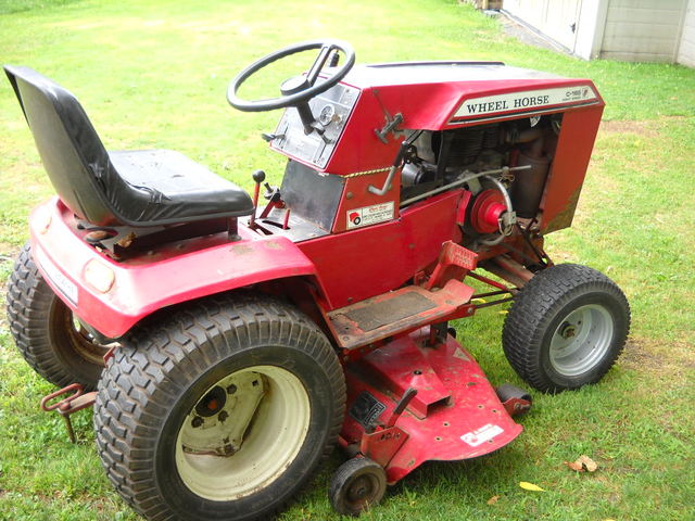

Road-Track 39 #1 Posted July 20, 2012 Well, I was mowing the lawn last month during the hot spell with my 83' C145A and had forgotten to check the oil after using it for a few hours the day before. While I was mowing a side hill the engine started to seize....I quickly shut it down and checked the oil...empty. I put 1.5 qts in and got the engine to turn over then start... A few moments later it started to knock. (Turns out the dipper broke and a nut on the rod cap came off, but didn't throw the rod.) Now I spy a C165 8sp on CL ....Road Trip!!! When I got to the sellers the tractor wouldn't fire. It was a 1984 with the metal pan and a front wheel and PTO from a newer 520. After checking everything and putting in the battery I brought. We found the points needed a clean and fired it up. The head gasket was leaking... I re-torqued the head and stopped the leak. I found the nice looking rust hole/weld free 42" SD deck was sprung and made some strange cuts. Well after some dickering ( called Horse Trading in these cases) I brought the beast home at a fairer price. After cleaning the carbon build-up and replacing the head gasket, spark plug, oil and greasing/oiling every moving part. The tractor runs strong with only a slight puff at start. I found the deck was a 1986 and the blades hang down about 1/2" below the front edge of the deck. Definitely sprung so I am using my older 42". Last week I was looking at CL again for some reason and came across a Snow Cab! I am now banned from CL by my wife for a few weeks... The story continues, but will have to wait for another day Share this post Link to post Share on other sites

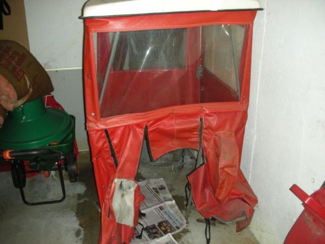

KC9KAS 4,746 #2 Posted July 20, 2012 Nice looking cab. I bought my 8th WH last weekend (wife was with me, so no surprizes) and she said, I think you need to start thinning the herd. I said, "Yes dear"! Share this post Link to post Share on other sites

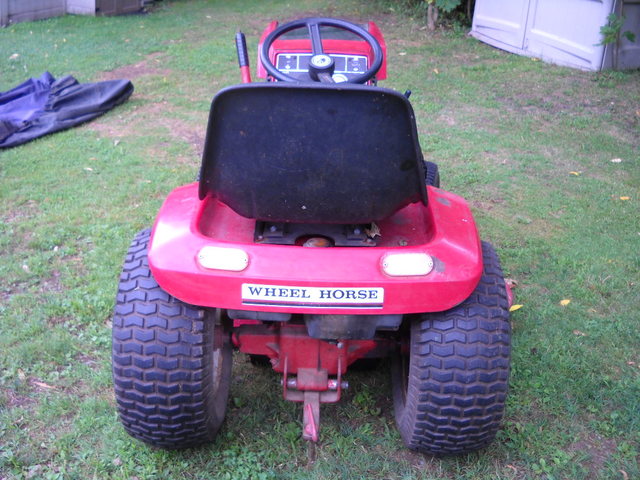

SNYFIX 13 #5 Posted July 20, 2012 Your right rear hub has loosened up and slid in -- Left that way the 1/2 moon axle key will eventually work it's way out and/or the hub will wear the trans housing down so a leak can result from a worn out seal. Share this post Link to post Share on other sites
Road-Track 39 #6 Posted July 20, 2012 :bow-blue: Eagle Eye! Thanks, you are correct. I found the hub was about 1/2 inch in and one of the bolts was broken off at the hub. The other side is fine but both sides show seal weeping. I will have to perform a little surgery You can see the right wheel is farther in The other side was OK The cab is going on the C145 for snowplowing duties once I rebuilt the engine. Thanks for the tip! I had checked my C145 when I got it and didn't have a problem. Share this post Link to post Share on other sites
