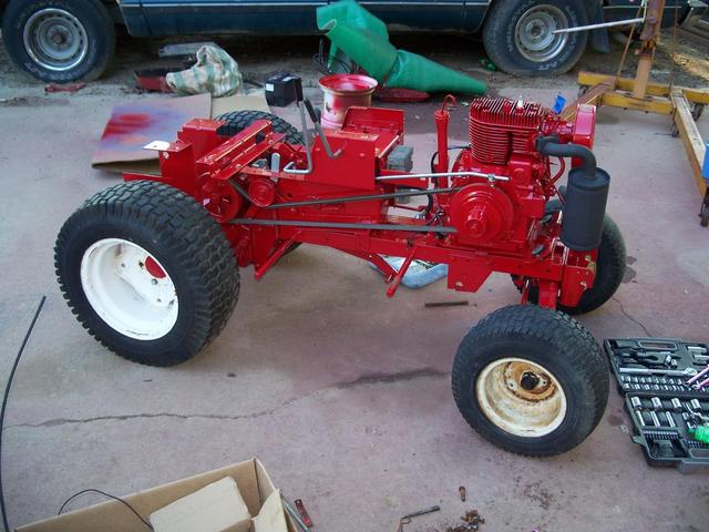

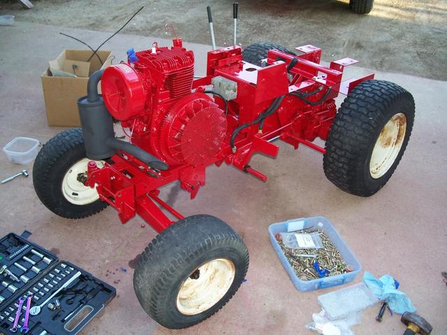

We got a few things bolted back together carefully, no chips or scratches, I painted some small stuff with rattle cans, black, silver and I did buy one can of Majic IH red it does match the gal. pretty good, I did a few brackets with it.
I worked on the sulky some also, found a seat and backrest for it
Well here is where I stopped tonight

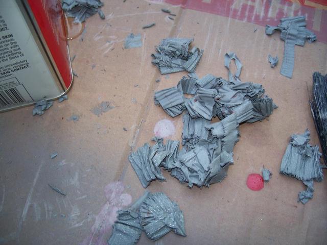

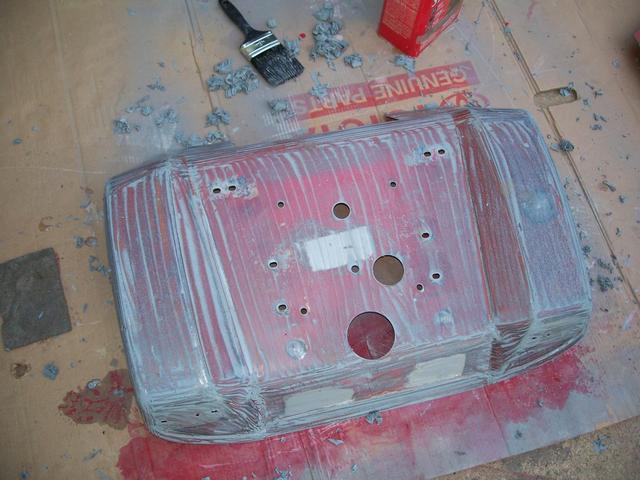

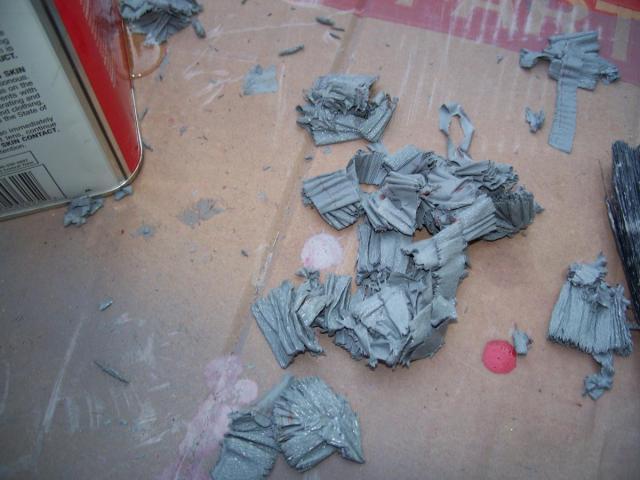

Well the primer was still not dry, so off it came, I used a putty knife to scrape it off, then tried stripper to get the rest off, but that made a mess, then I thought this is oil base and the stripper is like $8 a can, but gas is only $3.50 so I poured some gas on it, the primer wiped right off, used about half gal. after scraping it, now I'm back to where I started, I hope to have good primer on it after work tomorrow.

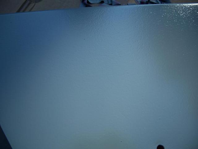

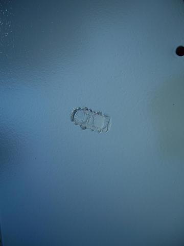

Primer after 3 days, I could still rub it off with my finger, I do not recomend this primer for anything.
Same spot as above with a push of my finger
After scraping the primer off with a putty knife

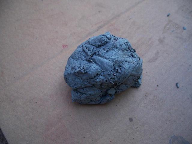

I could ball the primer up like clay, after scraping it off, this is 3 days in 90 deg weather
