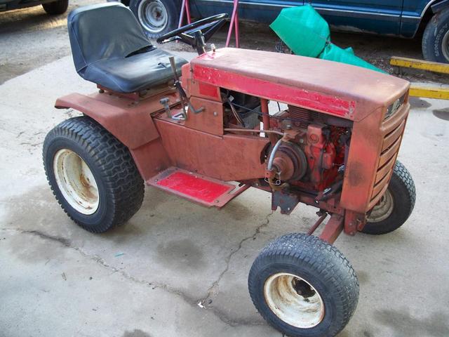

Well my parents are coming up from TX for the MI WH show, they have wanted to for a few years, I talked to Mom the other day and she said Dad wants to come and look at all the stuff, but he don't get around very well any more and figured after 20 min. he would be done, I said well I think I know someone that has a few tractors they could ride around, she was thrilled, but wanted to be sure she could drive it, like her C-120 auto I said no problem I have a couple autos here for them to use, but they are not real pretty, she said she didn't care, well after getting off the phone me and Ryan went out back to pick a tractor, I tried selling this nice running C-121 on here and on CL for $300 and no takers, we have put about 3 hours time on this using it around the yard to haul stuff and what not, well I figured I can't have them riding a ugly tractor, with me being the host, so it is getting a quick make over, not a restore but just a quick repaint new decals, and tidy up the wiring, new fuel lines, nicer seat, you know the basic stuff to make it a nicer user tractor, me and Ryan tore into it peeling the decals off, then last night we took all the sheet metal off, and pulled the wiring and a few other things, today we loaded it up and took it to the car wash for a bath, it cleaned up nice, taking this tractor apart we found it is in very nice shape, with little wear and tear on it, looks to have been well cared for except the paint, we took more apart then I planned but that is the way it always goes, I think I might try the new Magic paint line at TSC on this just to see if I like it, I took 10 rims to the powder coater today 4 fronts and 6 rears (2 for the raffle tires) then 4 are going on this C-121 then I 'll have a set of 4 ready to put on something else later, and for the price you can't beat it, he is blasting all 10 rims and powder coating them for $130 and this is not a guy in a back yard, this place has a blaster that the hose looks like it goes on a fire truck, the the bake booth you can fit a semi trailer in it, I can't blast them and buy paint for that price.
anyway here is our mini project, I hope to have done in a week or so.

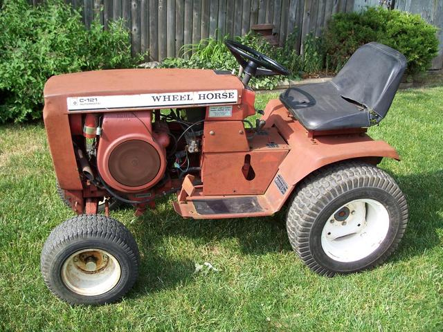

in the begining
sans decals, I hate removing them.

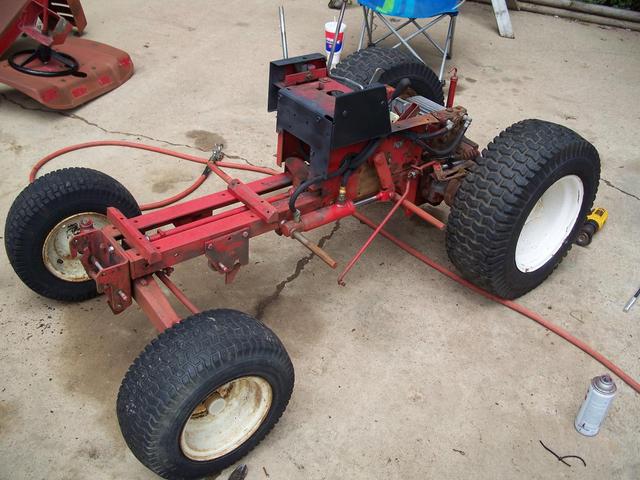

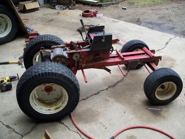

after a bath and a little more tear down, shot some rattle can primer on the sides of the dash tower.

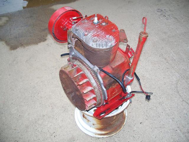

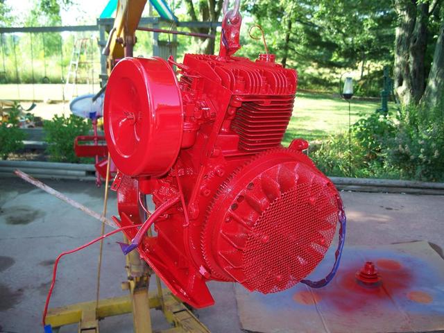

engine about ready for a coat of red.

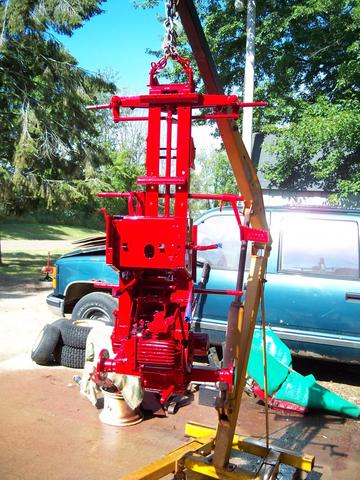

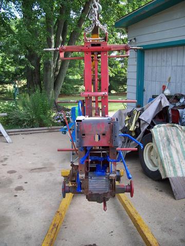

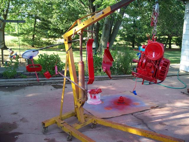

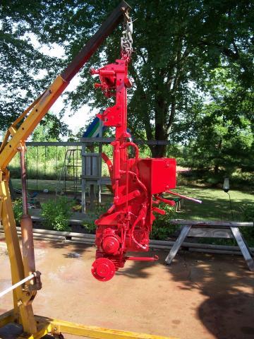

Quick little update, we got it wire wheeled and scuff padded lastnight, swapped in a new set of axle seals, then hung it on the engine hoist, taped up a few things, this is nothing like a real restore, but it will be just fine for what it will be used for, I bought a gal. of the Majic paint with reducer and hardener, it sprays pretty good, but like most cheap oil base paints the over spray is a sticky nasty mess, I know I don't like painting tractors together as well as in pieces, it is much harder to get all sides of things on it, with out running the paint, no runs but a few heavy spots here and there, it does flow out good, and with it staying wet longer it is easy to blend areas that you painted with out dry spray, I shot it this morning about 9am at 78 deg, it is going to be in the 90's today so I hope it helps dry it.
I wet the driveway but the paint stays wet so long the water drys and the paint still sticks to the cement, I rewet it but I think I will have a red drive again this year :hide: like most years in the past, I sent the rims out with other rims to be blasted and powder coated, it in the end is cheaper and way faster than blasting and painting them myself.
I hope to have some Majic primer on the hood and fender later today to see if I like it, and should have the basic engine painted, and maybe a few other parts later today or first thing in the morning, it would be nice to have all the big stuff painted by wed. but we will see.

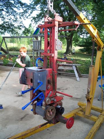

All hung and Ryan sweeping the driveway
It's Red, but look a bit orange like the Valspar IH red, but it will all be one color, so it is fine.

I like how you hang it like a deer for painting.....
varosd
looks great Kelly. like a bloody slab "O" beef!
  • Like 1

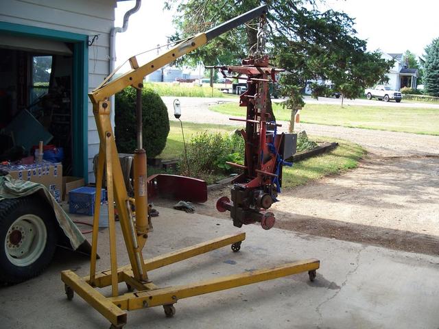

good idea using the cherry picker !!!!!

The cherry picker is a good idea, I had planned to put it up on jack stands, but would not have been able to get the bottom very good, I'm not real tall so painting the front was fun....not, but I think it looks ok, I'll know when I let it down, if it ever drys.

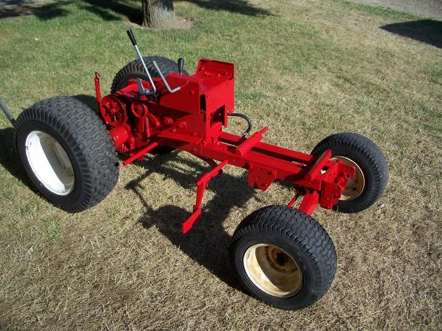

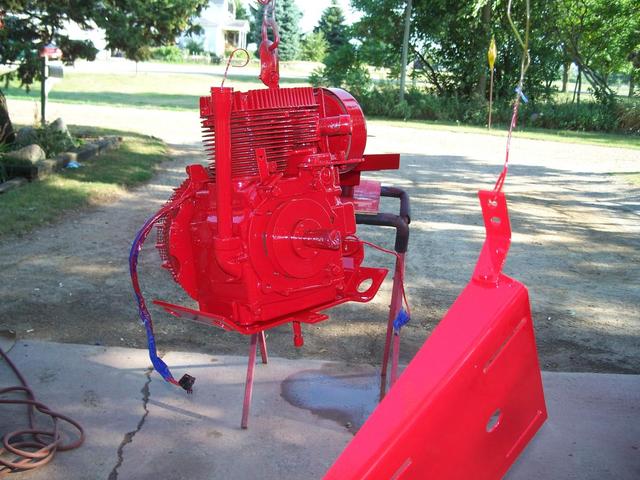

Well more is red, I got the engine, seat mount, dash, PTO bell, and a number of brackets, all done, lets see how long this takes to dry, I upped the hardener a little to see what that will do?? I know too much and it takes longer to dry, but we will see, I can say one thing for this paint it covers good.

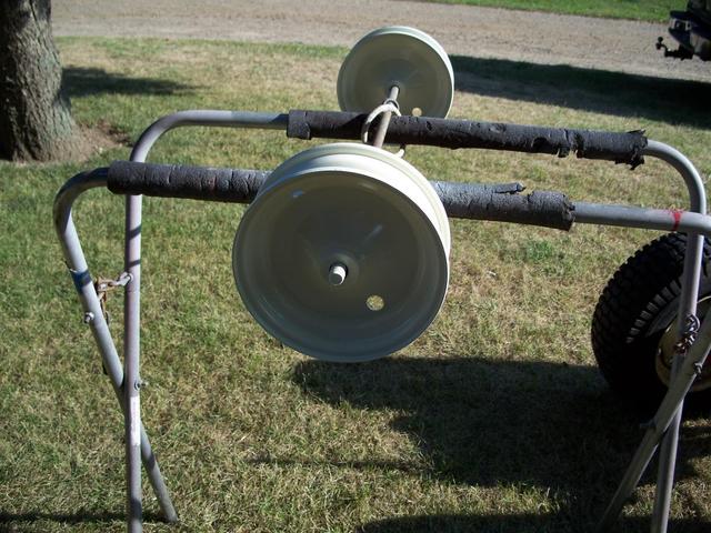

I got the chassis on it's wheels again, and painted the rims for the sulky, I can see the end, but I have to wait till stuff drys, and the primer is still wet, if it's not dry tomorrow after work I may strip it off the parts.
I didn't take it apart much, painted it about the way the factory did.
cherry picker comes in handy to hang stuff for paint.
Back on the ground
sulky rims, Krylon Ivory
