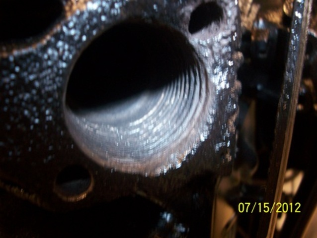

rockinhorse 45 #7 Posted July 15, 2012 The threads in exhaust are bad. Threads are half full of carbon deposits ,rust , wear. When i start a new pipe it cuts the edge off of the threads on pipe . Will get some pics to show that will help explain. Martin where did you get your pipe tap? Share this post Link to post Share on other sites
Anglo Traction 761 #8 Posted July 15, 2012 As already mentioned , you need a 1" NPT (National Pipe Thread Taper). NPS is a Straight (parrallel) Thread pattern. You definately need to clean out all the Theads that are clogged. I do this by hand, but Martin's Tap use is the best way. This thread pattern should when cleaned, allow you to screw the pipe in by hand to a depth of about 4 threads (0.4 ")BY HAND. You then tighten it a further 3/4 of a turn with a wrench IF it can. You must also use a Sealant on the threads. Hope this helps. Share this post Link to post Share on other sites

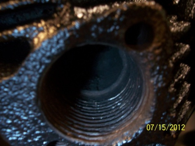

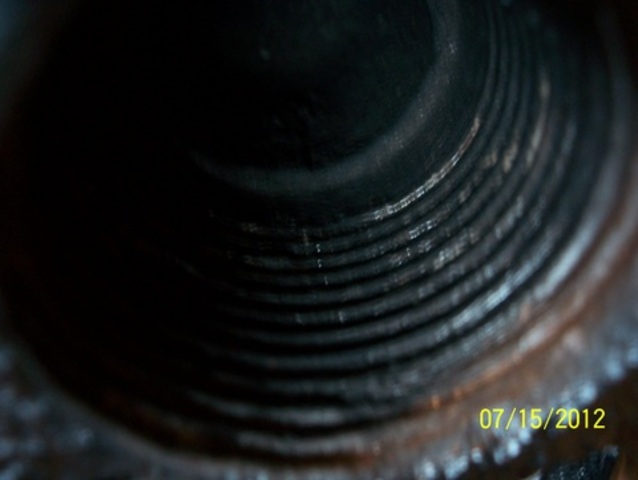

rockinhorse 45 #14 Posted July 15, 2012 OK Guys i got some pics. The p/o had a flange with about 1/2" inside exhaust port . It was 4" pipe 2 pipe fittings another4" pipe and then a tractor muffler (full size tractor muffler) then rain cap all this was held up by a angle iron bracket bolted to frame. No flange bolts no gasket nothing. Flange was beating on threads plus all the carbon deposits in threads. Hope the pics show how bad the threads are. You guys are right i will get a pipe tap, Does'nt hurt to extra tools around. thanks again for all your help!!! Karl Share this post Link to post Share on other sites
rmaynard 16,836 #15 Posted July 15, 2012 Just my 2 cents worth, but your threads don't look all that bad from here. I would just chase them with a piece of 1" threaded pipe and some PB Blaster, turning it in a little, out, in a little more, out, etc., until the threads are clean. Remember, because the threads are tapered, you won't get the pipe to turn all the way in. Then put a little anti-seize on your new pipe, screw it in, and call it a day. :icecream: Share this post Link to post Share on other sites
Martin 2,133 #16 Posted July 15, 2012 believe it or not those threads arent really that bad. im pretty happy if they look that good to begin with. yours are very savable, a tap or the method i described with a pipe nipple grooved should clean that up nicely. sometimes the pipe male thread on nipples arent cut into the end deep enough and it makes it real hard to get a few threads in the port before it goes tight. if you have access to a 1" pipe die that you can cut the thread on the end of the pipe a little deeper that will help also. because the thread is a taper if you reduce the male end and increase the female (exhaust port in this case) it will help you to get more pipe in the hole...... Share this post Link to post Share on other sites
