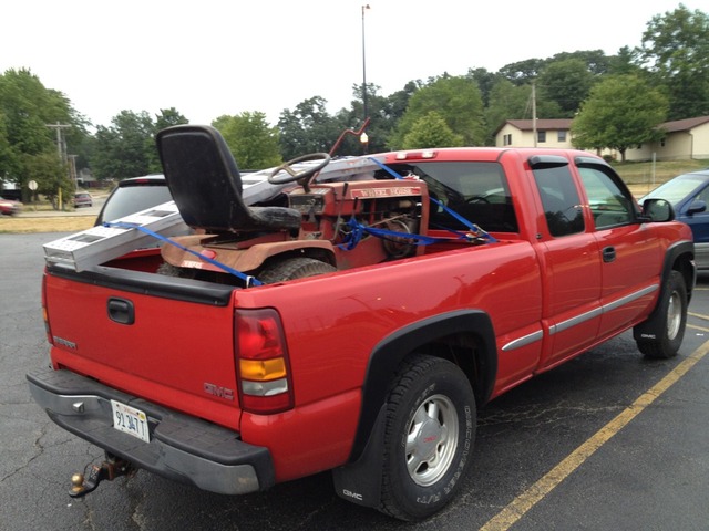

I'm sitting in pizza hut posting this on my phone because I can't wait until I get home to post on my computer. Just picked up a c160 with excellent looking deck and snowblower. Very straight and complete tractor and nice looking attachments. Here's the only pic I have at the moment, more to come ..........
Like I need any more on my plate right now.......post-4321-134222826281_thumb.jpg

just finished outside for the day, got it running, was a bad coil and condenser, but i also cleaned the fuel system and replaced hose, shut off valve and tank bung. drained the engine and hydro oil, flushed the engine with diesel, and installed a new toro filter on the trans.... tow valve was stuck, so also had to free up that.
gave it a clean up and fixed a few small things.
i think i got a good one here, couldnt be happier with how it runs, everything works well, hydro lift is a little damp but not dripping, hopefully it will be ok for a while. the trans is a little jumpy when starting to move in either direction. so i need to work on the cam plate area. the plate is a little torn up so i will get a new one and fix any minor issues there.....
