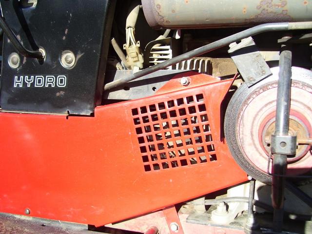

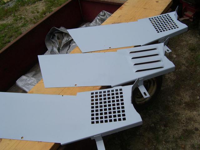

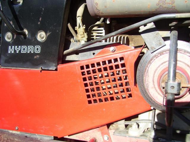

jay in nc 210 #2 Posted July 8, 2012 i'd vent the belt guard first then do the firewall. varosd just posted in modifactions the belt guard i sold him at the big show. this is the one on my 518. mowed high field grass with it yesterday 102 deg. works well . will be making 3 more with louvers in them. & still have 2 with square holes. Jay Share this post Link to post Share on other sites
