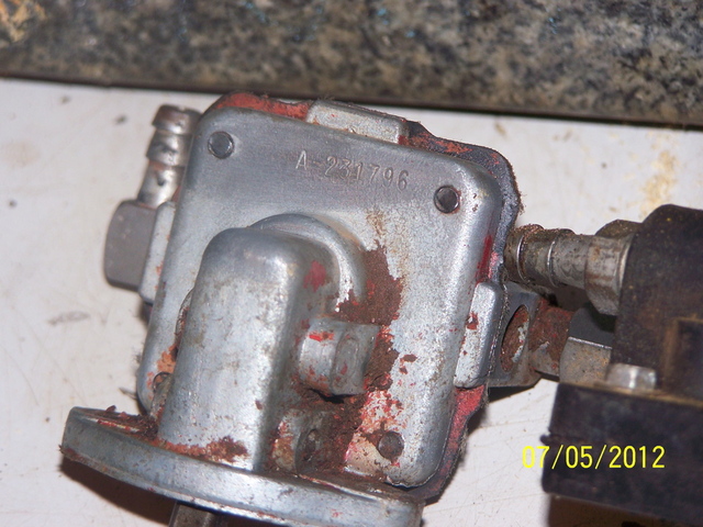

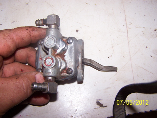

vinceo 34 #1 Posted July 6, 2012 Hey guys I need some help please. My neighbor has a B 80 with a 181 on it and I cant find a spec number on it. What I need is a new fuel pump, or rebuild kit. I looked today at work on kohlers site and I could only find one that has the plunger arm that is bent about 90*, the one on this horse looks like an "S" kinda. I did find a thread where a guy here make the rebuild kit that looks like it may work. Id like to find a new one if they are still aval. I did find a number on the housing A231796. Also is there someone here that parts out WH's he will also need a good steering shaft and gear, down the road. TIA vince Share this post Link to post Share on other sites

vinceo 34 #7 Posted July 6, 2012 This one is working, kinda, its leaking fuel back into the crank case. He wats to keep it stock. I went threw like 40 pages yesterday on kohlers site looking for wheel horses. Found 4 with this motor in them. So I wrote down all the specs I found, then looked at the pump break down. I found one that started with an "A" for the pump. I will have to build this eng this winter, and Ill check out the cam for sure. His bigest problem is he dosnt like to change air filters and fastest he runs the eng is maybe half speed. Ive told him that the air cooled engs need to be run high speed when were working in the garden to keep the jug cool. Its had 2 sets of rings in it all ready. I think hes afraid to wear the eng out if he runs it at ful throtal. Im going to do some more digging today and if I can find anythng Ill get that rebuild kit from the classic car guy. Thanks everyone for the help! Share this post Link to post Share on other sites
rmaynard 17,447 #8 Posted July 6, 2012 You have to be careful in rebuilding an alloy (metal) pump. Even if you can find the proper rebuild kit, sometimes the inside of the pump is so corroded from moisture that it is impossible to get the check valves to seal, even if they are new. The stock engines on B-80's were either a K181-30461D or 30629D. Both call for the same pump A-231796-S, which has been superseded by 41-559-05-S, which is a plastic replacement pump. Kohler is not making a metal pump. Share this post Link to post Share on other sites

vinceo 34 #11 Posted July 21, 2012 Well guys I got to say BIG THANKS for the link to the rebuild kit. Man what great work that guy dose. Got the pup rebuilt and rebuilt the carb and so far no leaks back into the crank case. I liked the kit so much that the next one that comes threw at work, im going to order it and put it in, if the housing isnt bad, this will save our customers alot of money! Thanks again vince Share this post Link to post Share on other sites
