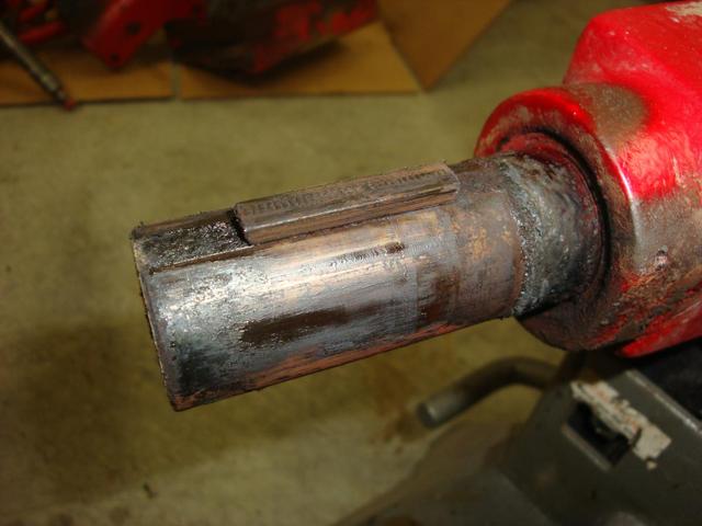

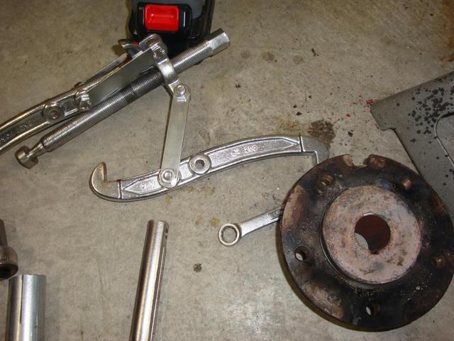

bean 85 #8 Posted July 3, 2012 I finally got it off. I combined parts from 2 pullers to make it work. I had to turn the bolt with an impact wrench, while I held the hub from turning with a breaker bar. it came off HARD all the way. the puller was so hot, I could barely touch it. after I removed it, I looked at the keyway, hub, and axle, and everything looked good. not sure what all the complication was about. I am going to tackle the seal in a few days. the local store didn't have the napa part. there is a napa 10 miles from the house. I will have to call and see if they have it. thanks everyone, for the advice :thanks: Share this post Link to post Share on other sites

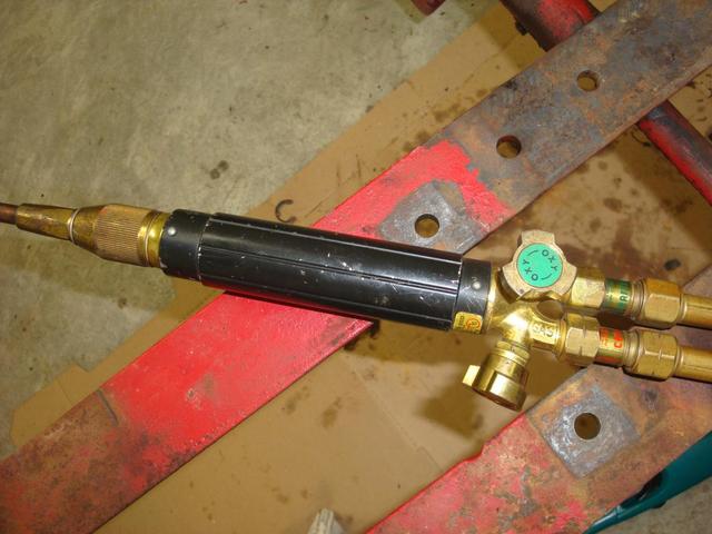

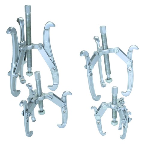

Zeek 2,299 #10 Posted July 4, 2012 I bought this puller set from Harbor Freight for about $20 http://www.harborfre...-set-40965.html You will need the BIG one. I then used an ox-acetaline set up an heated the hub cherry. Propane may not do it. The hub is think and take A LOT of heat. Hammer, twist, hammer, twist, hammer, twist - tightest thing I ever removed Can't believe nothing snapped . . Finally came off - a lot of corrosion underneath My seals were already leaking and I knew I was redoing the tranny, so heat wasn't a concern for me. Good luck, that's a job I never wish on anyone :confusion-waiting: Share this post Link to post Share on other sites

Rooster 192 #12 Posted July 4, 2012 If you do use heat try this method. Heat the hub cherry red then quench it with water. Ignore anybody who tells you this could crack the hub. I understand their logic, and theoretically they are correct, it could, but it won't!! I did this for 20 years before I discovered electrolysis. Have removed flywheels pulleys and all types of hubs this way. Basically, the hub and axle are different materials and expand at different rates, the hub growing more and faster. Add to that you are only directly heating the hub. Then the quench causes a rapid change in size. All if this will break the "corrosion adhesion" between the parts. I learned this working for a valve company where I started in tear down. Taking apart any where from 3" to 40" valves that had been in refineries for as long as 20 years sometimes in very harsh environments. Bolts that a1-1/2" impact would not touch would spin right apart afterwards! Share this post Link to post Share on other sites

SousaKerry 503 #17 Posted September 13, 2012 Before you put that hub back on put the rear end up on jack stands start the tractor and run the transmission at full speed. Grab a strip of emery paper wrap it 3/4 arround the shaft and polish it up real good. Use a file to clean up the keyway and use some neverseeze on the hub during re assembly. Share this post Link to post Share on other sites
Rooster 192 #18 Posted September 17, 2012 Before you put that hub back on put the rear end up on jack stands start the tractor and run the transmission at full speed. Grab a strip of emery paper wrap it 3/4 arround the shaft and polish it up real good. Use a file to clean up the keyway and use some neverseeze on the hub during re assembly. Be careful when doing this. Do not wrap the emery cloth around your fingers and hold onto it lightly! The key way can snag it and pull your fingers into it! A lot of machinist out there missing digits from polishing shafts on lathes. It is an every day practice, but takes care to be safe. 1 Share this post Link to post Share on other sites
tommyg 154 #19 Posted September 19, 2012 You probably have your hub back on already, but in case you don't, after losing my religion trying to remove a hub from my D-180, I made sure I coated the shaft with anti-seize compound before reinstalling in case I ever have to take it off again. 1 Share this post Link to post Share on other sites
