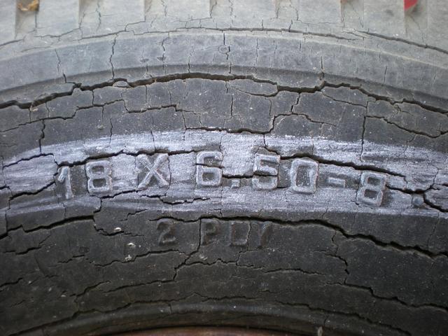

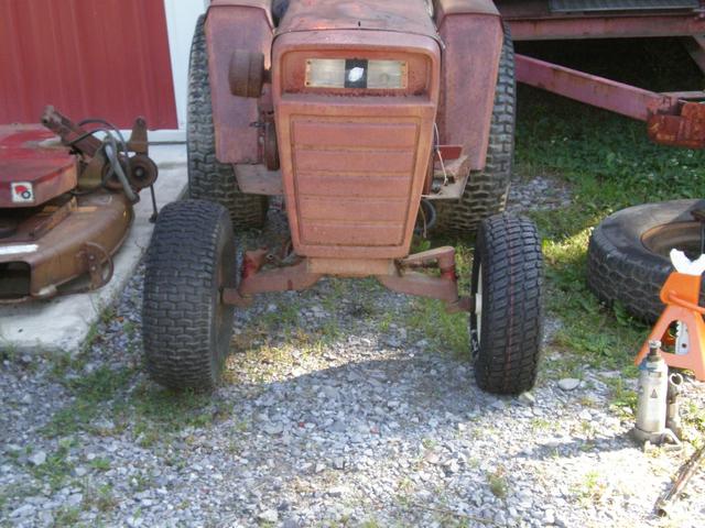

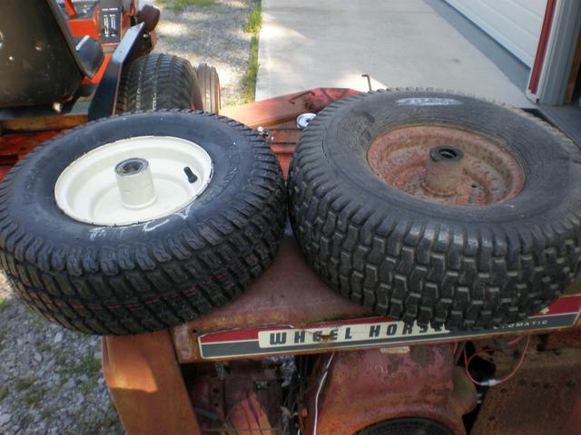

Pollack Pete 2,273 #1 Posted June 28, 2012 I got tired of putting air in one front tire of one of my GT-14's,so I bit the bullet and bought 2 new Carlisle Turf Master size 18x 6.50- 8.I beadblasted and primed the rim that had the flat on it.UPS brought the new tires yesterday.I mounted one new tire on the freshly painted rim this morning.Low and behold,lookie how small the new tire is for being "the same size".What gives here anyway? Did Carlisle's tire molds shrink?Did they downsize their tire sizes like everything else you buy today?I hate the new smaller size tire.I wanted the big fat ones like on the left in my pic.Any comments? Share this post Link to post Share on other sites

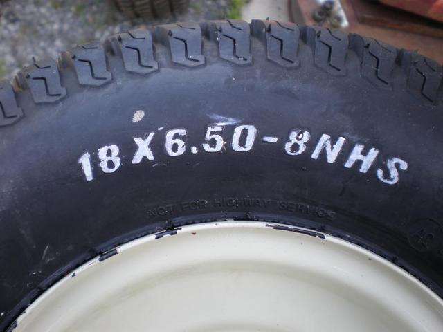

Pollack Pete 2,273 #4 Posted June 28, 2012 Looks shorter and narrower not 6 1/2 " wide. Where were whey made? I measured my old tire.An honest 18 inches tall and at least 61/2 inches wide.New tire is a puny 17 inches tall and barely 51/2 wide.Mounted on same width rims. .I compared a mounted 16x 6.50-8 tire.I can't tell the difference between the two.I searched the entire sidewalls of the new tire..Nowhere does it say where they were made.I'd guess some Asian country.Looks like I'm done buying Carlisle tires.Especially at the price they charge.I hate the new,short,narrow tires for my GT-14.Anyone here buy any 18x6.50-8 tires lately that are the same physical size as the old ones?I'll save these to use on one of my B or C series tractors. Share this post Link to post Share on other sites
Fun Engineer 863 #5 Posted June 28, 2012 The size of these resembles the NLA 16x5.5x8. This may be good news for us 1960's guys. Share this post Link to post Share on other sites

Pollack Pete 2,273 #9 Posted June 28, 2012 hi pete, i've noticed on SOME carslile tires that it says "made in china" under the bead. in other words, once the tire is mounted you cannot see where the tire was made. SOME carslile tires are made overseas and SOME are made in U.S.A. regards mike in mass. Hey Mike in Mass,you're right on about looking on the bead.I took the tire off the rim and with great difficulty (59 year old eyes) saw in tiny print those dreaded words Made in China..About that big too.I found 2 Deestone tires on Fleabay.I just ordered them.I'm all done with Carlisle unless I can see them in person before I buy.Thanks everyone for all the info. Share this post Link to post Share on other sites
