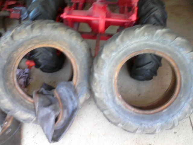

octfst 378 #34 Posted July 2, 2012 Thanks fireman the pics & info are very helpful. still a long way from being ready for next years show. I knew about the hood stand and mine looks original as for the shifter thats not the original trans not sure about the shifter. Just got back from Greentown Ohio picked up a pair of tires & tubes off CL for 50 bucks Share this post Link to post Share on other sites

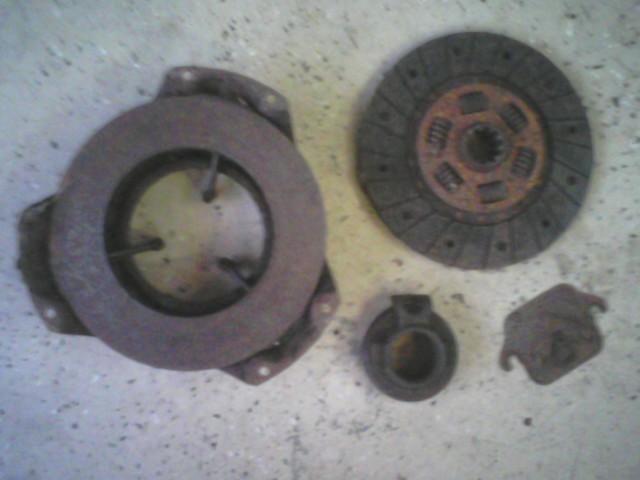

octfst 378 #35 Posted July 9, 2012 got 9" clutch & pressure plate throw out bearing & transmission inspection cover today off CL down to flywheel and back gear then should be time to put it all together Share this post Link to post Share on other sites
