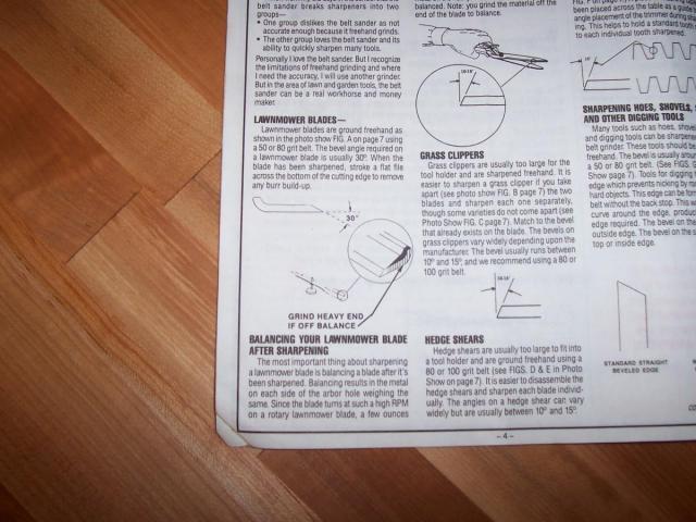

A question also about balancing the blades. This is from an older manual I inherited with the foley belsaw equipment. I always grinded a bit more of the cutting edge to balance them?

I always assumed that this was to lengthen the life of the blades. Grinding a little extra off the wear surface means they will reach their limit a bit faster.
Are you asking why would you grind the back side for balancing? It's because a blade measurement is diagonal from the outside cutting tip point across to the backside cutting tip point. Not the length of the flat bar it's made from. If you start taking too much off the outside, you run the risk of making your blades to short and they won't overlap when cutting. If you grind the cutting edge to balance, essentially you're giving away a little extra life on your blade.

I grind my blades at 45 Degrees. With 30 Degrees I get too much blade damage as I have a lot of driveway and parking areas with gravel and lose stone to mow around.
