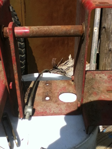

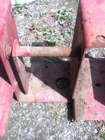

dennist 139 #10 Posted June 20, 2012 This is what it would look like with the seat pan removed- Then with the cable hooked- Share this post Link to post Share on other sites
joel_400 59 #11 Posted June 21, 2012 Yeah what he said and showed! Thats the part you need. If you cant find one let me know I happen to know a guy that may have one. Joel Share this post Link to post Share on other sites
