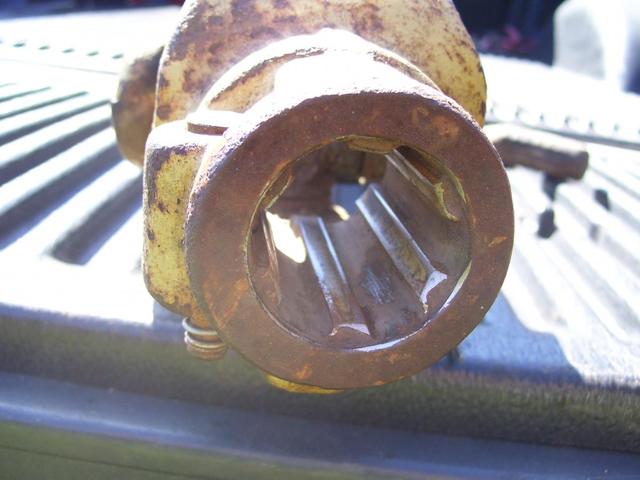

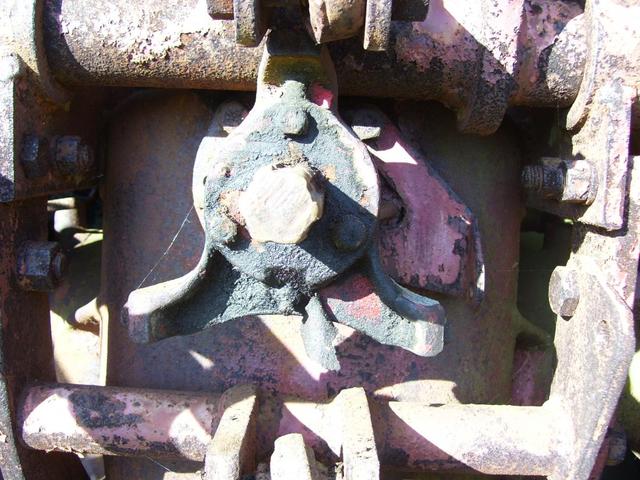

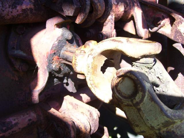

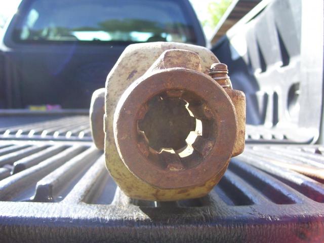

ok i checked , my pto tip was cut off w. a hack saw by some P.O. . my drive shaft would almost start on but wouldn't i cleaned & filed the pto , then i ran a flapper wheel on the inside of the driveshaft cleaning it up and every thing fits well. tight tolerances, clean well. side note it has been 20 years sence i mowed with this tractor & 5 years sence i used this drive shaft. my old bush hog shaft went on easy ,but that was a long time ago.

After looking at your pics I think I may have to replace the coupler on the drive shaft of the mower. The PTO shaft on the tractor in in excellent shape. it's never been used, I had to take the cover off of it to try to hook things up. It doesn't have a groove in it like the newer ones for the spring loaded lock pin, it has a hole drilled through it for a pin/bolt to go through to keep it from sliding off the shaft. If I can get a decent pic of the coupler on the mower drive shaft I'll post it. Thanks for the pics and advise Jay.
