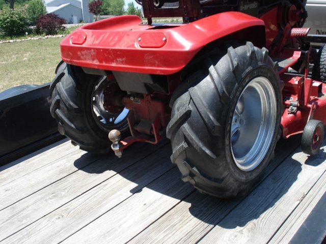

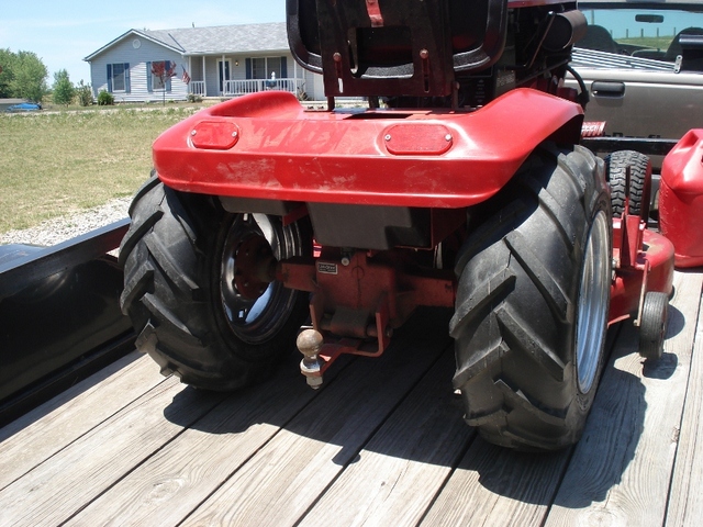

bean 85 #1 Posted June 15, 2012 just finished installing new 23x8.50-12 deestone ags on the 310-8. just thought I would give you a little info, in case someone is considering them. I mounted them on 7" wheels. the height of the tires on 7" wheels is 22" and the width is 7.5" .mine are the 4ply version. the fit and finish on them is nice for an inexpensive tire. they were $93 for the pair,plus shipping, from GCT. now, the only downside, these tires ride ROUGH on hard surfaces, including my yard that hasn't had any rain for a week or two. we stated with 20psi, as recommended. then we went to 15psi, then 10psi. I have read a few threads that suggest 5psi.. my experience with these tires has been, the less pressure, the bumpier the ride. on the positive side, they will probably do very well in dirt and mud, as the rough ride indicates an aggressive tread pattern. the lug profile is very flat and that's a good thing for dirt/mud. so, in my opinion, they are well worth the relatively low price. :) Share this post Link to post Share on other sites

bean 85 #10 Posted June 16, 2012 Do you have inner-tubes in the tires? I would think with lower air pressure, the ride would be smoother! no inner tubes needed. it looks like the lower the air pressure, the flatter the profile gets and the bumpier. we went the other way and put in 25lbs, and the ride smoothed out considerably. Share this post Link to post Share on other sites
