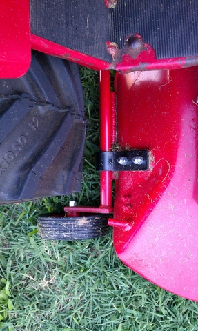

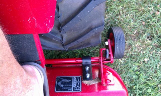

I have a 48 deck and they r close to wheels on it on mine.

here are a couple of pics of how close my tires are with a 48 inch deck.post-7389-0-63122900-1339802871_thumb.jppost-7389-0-44881000-1339802948_thumb.jp Thats with deck lowerd.With it up its really close but doesnt rub the tires anywhere.
