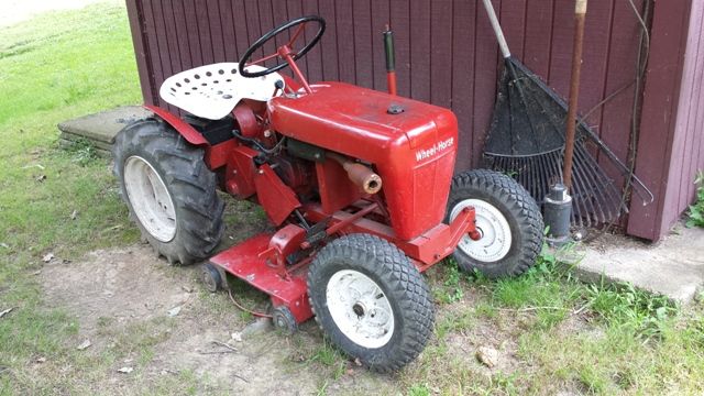

jsmoe 2 #17 Posted August 7, 2013 (edited) I've decided it's come time to sell the little horse. I don't want to give it away and would just like a fair price from it. The trouble is, I don't know what a fair price would be . Any estimates would be appreciated! http://s715.photobucket.com/user/jsmoe2003/library/?sort=3&page=1 http://i715.photobucket.com/albums/ww153/jsmoe2003/20130807_142333.jpg Edited August 7, 2013 by jsmoe Share this post Link to post Share on other sites
546cowboy 302 #18 Posted August 7, 2013 Really nice little tractor there. I haven't had that many round hoods myself and no nut roasters so I would have no clue on price. Share this post Link to post Share on other sites
