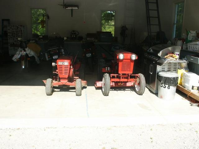

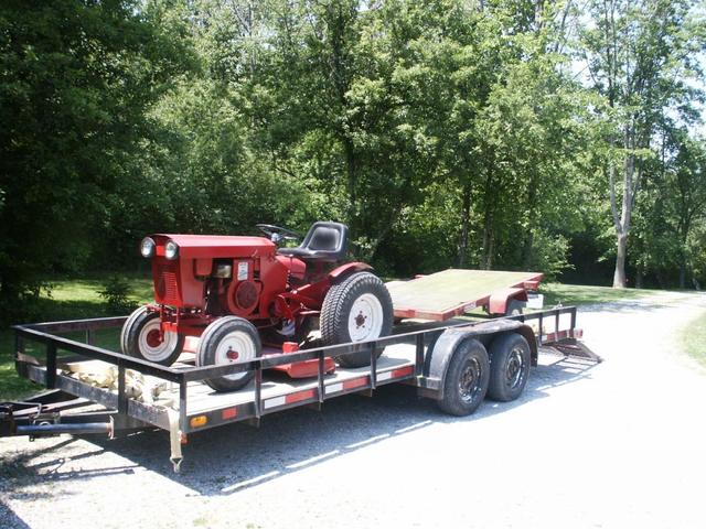

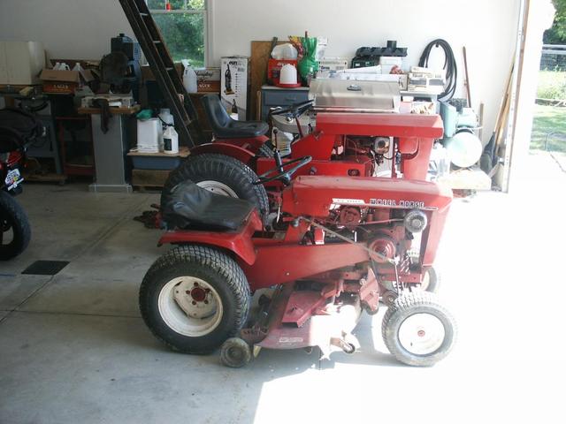

bluelinehiway 8 #8 Posted June 10, 2012 All: Well, yesterday I drove out to pick up the Speedex tractor Model 1632. Got the unit for $400 and on the way home, I found a small trailer that I bought for $50. Had to move the tractor forward on the car hauler to squeeze the small trailer on, but since I only had to drive about 4 miles with both purchases, I didn't strap down either one or readjust the tractor over the axles. Got a ton of stares as I rode throught town. I attached some pics of the Speedex next to my 1067. Holy cow, I didn't realize the size difference. The Speedex has a 16 hp B&S cast iron motor, a drive system consisting of v-belts; a T-92 tranny; chain to sprocket and final gear drive. All of this uses a "clutch" where the entire engine moves on the frame to provide tension on the initial drive belts. Got some work to do to sort out the carb, hydraulics and electrical, but since I normally do this on new units anyway, it gives me a chance to find everything that need going over. My apologies for taking this WH forum a little off track, but I like the idea I have an example of each of the two Pond Brothers' inventions. I entered a link that gives some history on how the two brothers took a different track on tractors. And since the Speedex was made in my wife's home town of Ravenna Ohio (her neighbor worked at Speedex coming out of high school), I used this connection to help her agree that my decision to park this tractor in the garage versus her car, was the right one. I also reminded her how much money we'll save on paint seeing that they are nearly the same color. Here is the link: http://www.speedextractorinformation.com/index.html Tom 1 Share this post Link to post Share on other sites

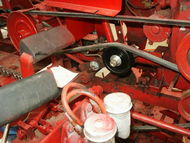

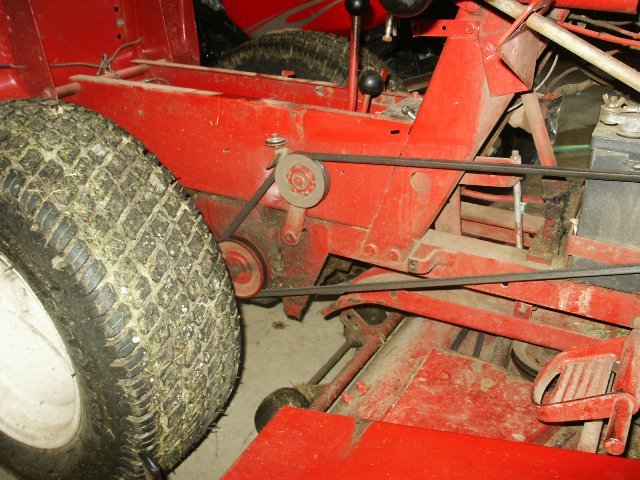

bluelinehiway 8 #10 Posted June 18, 2012 Kid: To the best of my knowledge, there has been one repaint. Once I started pulling the beast apart, I saw that the PO did indeed jerry-rig some items, but overall, it doesn't look all that bad. Even if it was "perfect", I'd probably pull it apart anyway just to see how it works. I did begin my "improvements" to the Speedex. The Speedex clutch is a moveable engine that sits on the frame on a carriage. As you push in the clutch, a small rod pushes the motor forward tightening engaging the belt. I thought that by pushing in the clutch actually engaged the drive belt versus disengaging it was kinda weird. My Dad's old Speedex used a 7 hp motor, and it was no big thing to push the motor forward to engage. Try that with a 16 hp cast iron motor. Not good and not smooth. And because the engine isn't fixed / bolted to the frame, the motor rattles and shakes like crazy. So a couple beers staring at the unit side by side with my 1067 and 310-8, I had a brainstorm. I decided to fix mount the motor on new frame mounts. Instead of a movable engine to act as a clutch, I decided to replicate the belt drive on the Wheel Horse. Have an idler pulley act as a tensioner on the belt (using the same existing pedal assembly, and when you pushed in the clutch, the belt would sag (idler tension off) and as you let off the clutch, a spring would return the idler pulley under tension. I have included a mock-up of my plan versus my WH inspiration,and a near finished pully bracket below. I have the parts painted and drying now to install tomorrow or Wednesday. After that, I have new ignition parts to install and see if this thing fires up. Tom Share this post Link to post Share on other sites

Rooster 192 #15 Posted June 20, 2012 Loving the clutch "spring"!! LOL IS that using the pulley as a brake? Share this post Link to post Share on other sites
