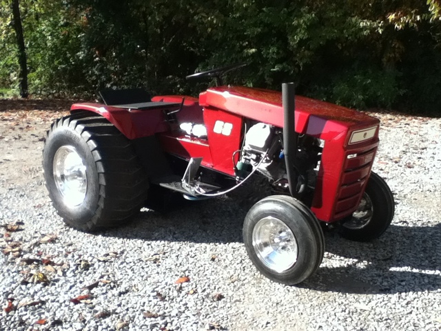

Tractor Addict 13 #26 Posted August 6, 2012 shes finally done other than the motor. :) 2 Share this post Link to post Share on other sites
horsesaver98 18 #27 Posted August 6, 2012 that is nice Share this post Link to post Share on other sites
AMC RULES 37,253 #28 Posted August 6, 2012 Gold leaf that Wheelhorse logo on the side. Share this post Link to post Share on other sites
Tractor Addict 13 #29 Posted August 6, 2012 Gold leaf that Wheelhorse logo on the side. i was actually talkin to my dad about that yesterday Share this post Link to post Share on other sites
whfan74 2,073 #30 Posted August 6, 2012 Great color choice! Gold accents would really set that off. Nice job! Share this post Link to post Share on other sites

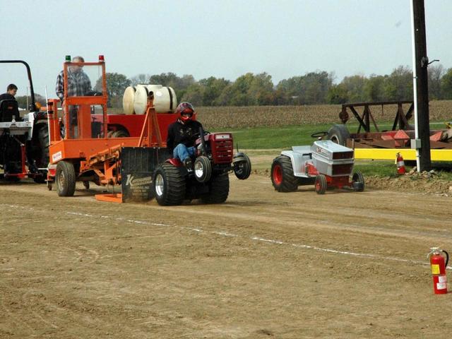

Tractor Addict 13 #42 Posted June 6, 2013 https://www.facebook.com/lee.insley.3#!/photo.php?v=10201076311220862&set=vb.244336408958346&type=2&theater I couldnt get a vid to upload on here so heres a link. I know it been a while since i posted but here the action pics. had a busy winter. broke the drive shaft and a rocker arm stud at my very first pull with it.. 2 Share this post Link to post Share on other sites
Moparfanforever 916 #43 Posted June 7, 2013 Those Command engines sure do sound sweet !!!! Very nice lookin' puller !! Share this post Link to post Share on other sites
Zeek 2,299 #44 Posted June 13, 2013 Love that color, can't wait to see the finished product! Share this post Link to post Share on other sites
AMC RULES 37,253 #45 Posted June 13, 2013 So...did you stop at the end of the track, or drag that sled all the way back into town? Share this post Link to post Share on other sites

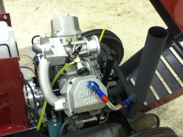

Deere Hunter 54 #48 Posted June 13, 2013 "broke the drive shaft and a rocker arm stud at my very first pull with it" What cam are you using and how much lift? I know I could not use the blue rockers that MWSC sold in the kit without having to clearence the rocker body or the pushrod would bind. After half a season I upgraded to Comp Pro Magnum Rockers and 7/16" studs and they stay in adjustment now. Those other rockers would go .020 out just rolling the engine over after adjusting. Share this post Link to post Share on other sites
B-100 Dan 7 #49 Posted June 14, 2013 Nice job. That is a great paint job, love the color. Makes me want to do mine, if I could go that long without using it... Share this post Link to post Share on other sites
Tractor Addict 13 #50 Posted October 30, 2013 "broke the drive shaft and a rocker arm stud at my very first pull with it" What cam are you using and how much lift? I know I could not use the blue rockers that MWSC sold in the kit without having to clearence the rocker body or the pushrod would bind. After half a season I upgraded to Comp Pro Magnum Rockers and 7/16" studs and they stay in adjustment now. Those other rockers would go .020 out just rolling the engine over after adjusting. its all taken care of now. the push rods were too long and like u said the body and stud were binding Share this post Link to post Share on other sites
