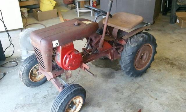

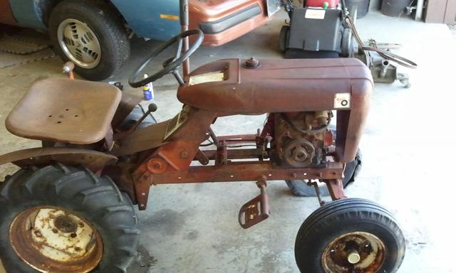

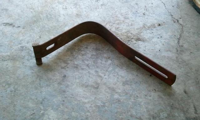

Bryan d 1 #1 Posted June 1, 2012 I got this tractor in trade and don't know anyway thing about it.for the life of me tell What this bent bracket is for ... except for a seat back? Who knows. I can also be reached at (801)989-0004 thanks to anyone that can help me. Share this post Link to post Share on other sites
kthack657 329 #2 Posted June 1, 2012 Nice looking tractor, looks like a 704, the bent bracket is for a seat, the long cutout is for the back rest. the other part is where it attaches to the seat. Oh almost forgot.... you are in a great place for knowledge on these little but mighty workers Share this post Link to post Share on other sites
Wheel Horse Kid 105 #3 Posted June 2, 2012 Looks like a solid machine to me! Share this post Link to post Share on other sites

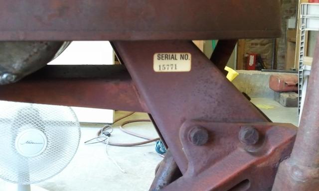

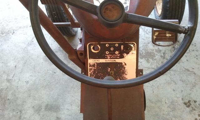

Kelly 1,035 #4 Posted June 2, 2012 I'm 99% sure it is a 1964 tractor, if the engine is orig. it will be a 704 with a 7hp kohler, but it is posibale that the engine has been swapped in and it was tecumseh powered and it could have been a 604 Share this post Link to post Share on other sites

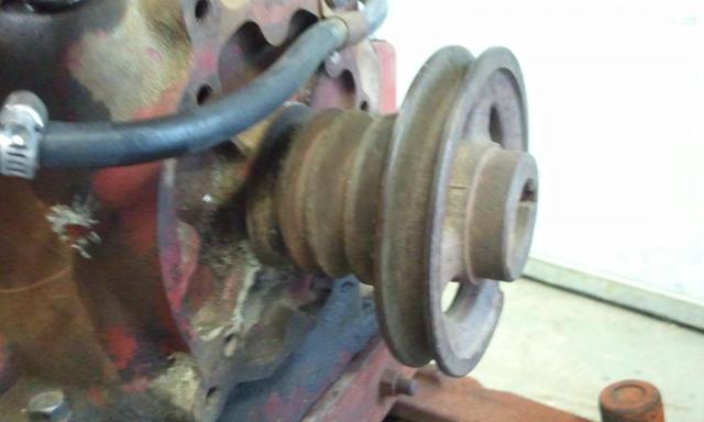

Kelly 1,035 #8 Posted June 2, 2012 For the belt the orig. part no. is 1576 the new part no. is 9691 and the belt is a 1/2"x 70", but it will not fit on your tractor with the engine pulley that is on it, that is not correct, it should be a 2.5" pulley, I should have a pulley and belt guard send me a PM Share this post Link to post Share on other sites

Bryan d 1 #13 Posted June 2, 2012 I plan on keeping it dirty brown for a while. But would like to get it running good. I need it for all the snow here in Utah! is this the correct pulley? Share this post Link to post Share on other sites
Kelly 1,035 #14 Posted June 2, 2012 The inner set of pulleys is correct, not sure what the outer pulley was for?? Share this post Link to post Share on other sites

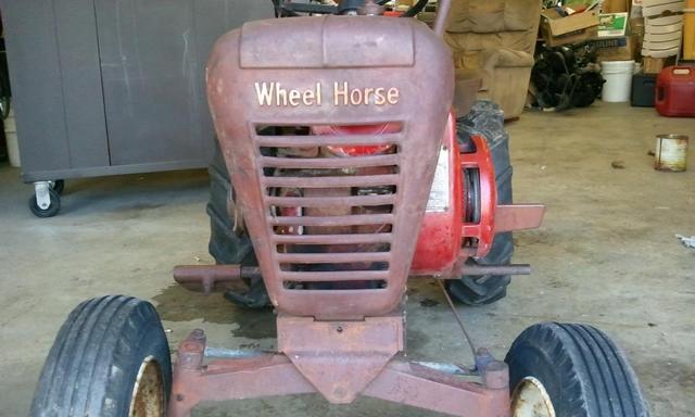

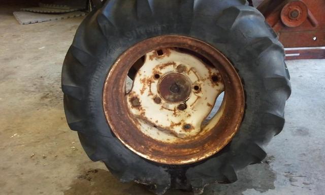

squonk 44,969 #15 Posted June 2, 2012 Heres a couple of pics of my 704 when i got it home. It's all original as far as I can tell except for the seat: 1 Share this post Link to post Share on other sites
Alan_Heist 7 #17 Posted June 3, 2012 Do you have the second wheel weight for it? I only see the one on the left in your pics. Nice Horse!! Welcome to RS!!! Share this post Link to post Share on other sites
Bryan d 1 #18 Posted June 3, 2012 Ya I have both rears and the front ones also. Plus a plow, discs. Why don't I ever see the back rest in any pictures? But I need a belt cover. Share this post Link to post Share on other sites
