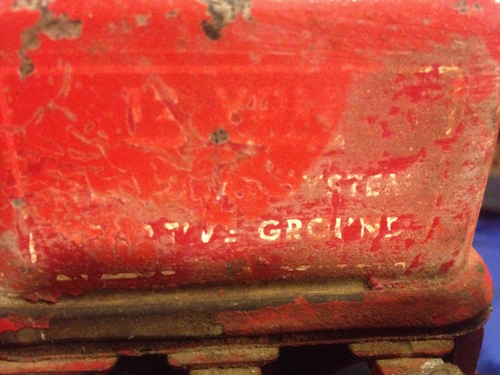

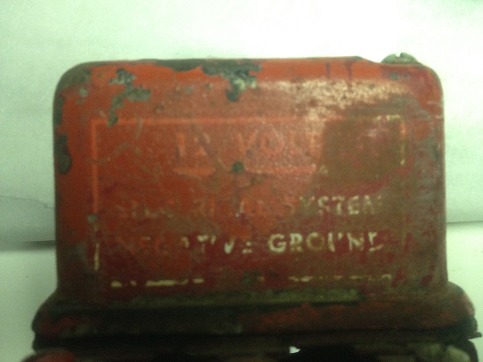

Does anyone have a source for a decal that was placed on side of the voltage regulator? If not, does anyone have a good picture and dimensions I could send to Terry and have him make one?
Martin
i was working with terry on making one for 2 of mine. we havent gotten very far, just time i guess
bit hard to read but is this the decal....

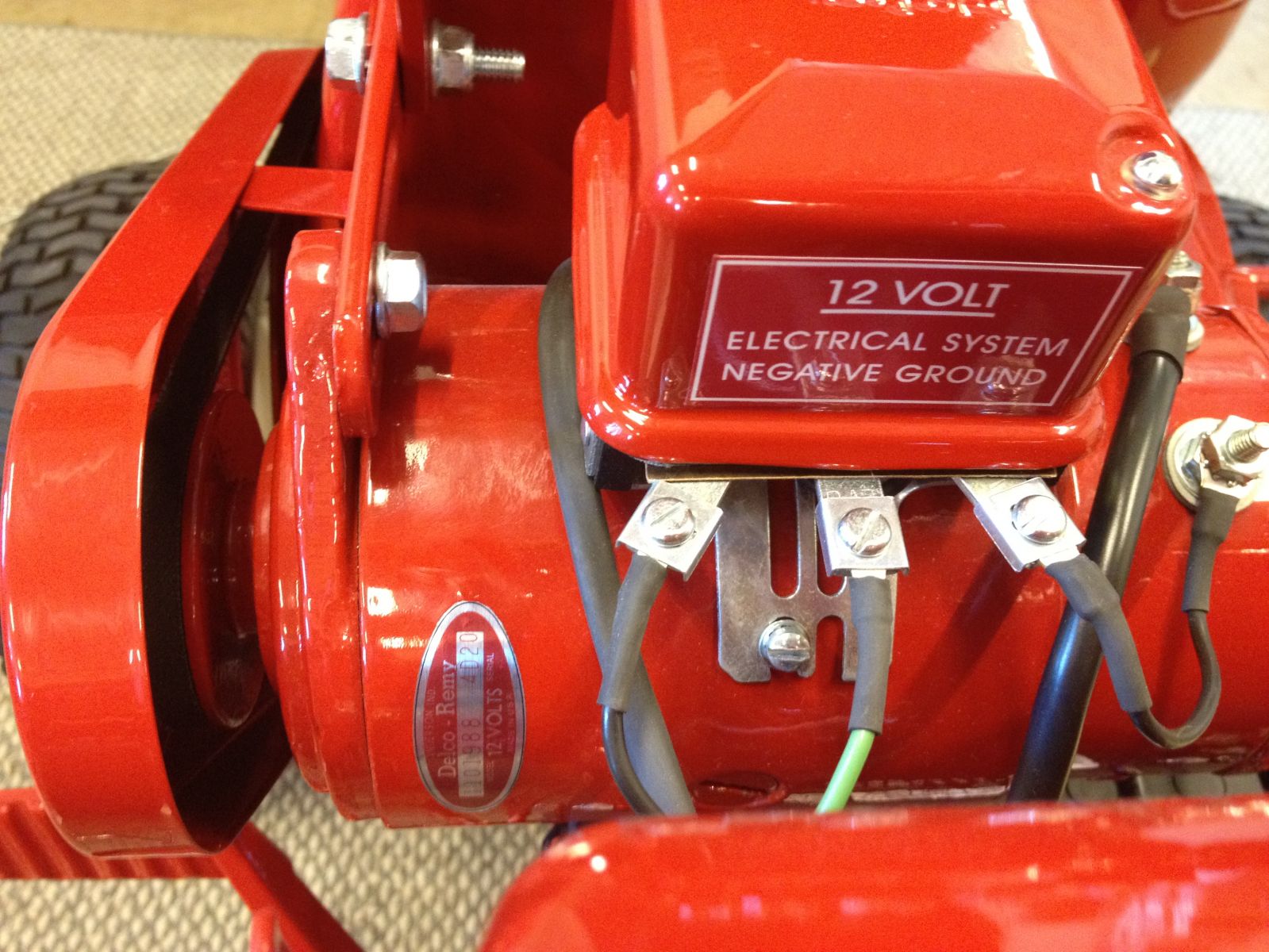

heres mine installed on the regulator......
Fun Engineer
Martin
What color is your tractor in the above picture?
Martin
I do all my red with ppg case red powder coat.
Sent from my iPhone using Tapatalk
Fun Engineer
Thanks. It looks brighter than my International Harvester Red.
