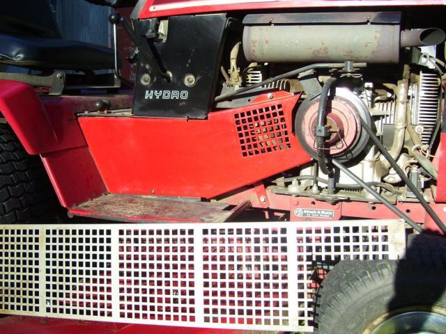

MalMac 1,334 #1 Posted May 30, 2012 I have seen the idea of cutting holes in the guard to let the hot air out to help cool. I think this is a good idea but I have not seen any post from people who have actually done it. I know it's got to help but does it cause a lot of hot air on the leg and foot? I know anything to help keep that Onan cool is a good thing. It's just hot air on the foot and leg is one thing but intolerable is another. Just wondering. Share this post Link to post Share on other sites
jay in nc 210 #2 Posted May 30, 2012 look in the classifieds i just posted some for sale & some wanted, heres a picture of the one on my 518 & the material i used to make it . it sure does move a lot of air! Jay 1 Share this post Link to post Share on other sites
liketoplayto 6 #3 Posted May 30, 2012 looks good jay Share this post Link to post Share on other sites
546cowboy 302 #4 Posted May 30, 2012 Now I think that looks much better than a bunch of holes drilled in there. :thumbs: Share this post Link to post Share on other sites
