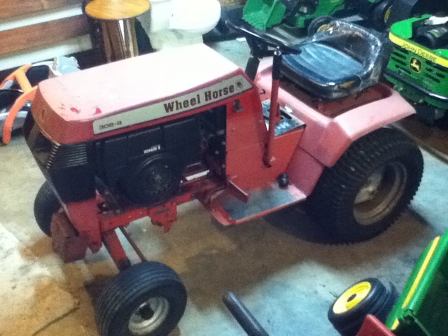

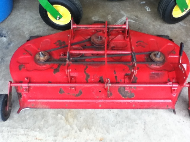

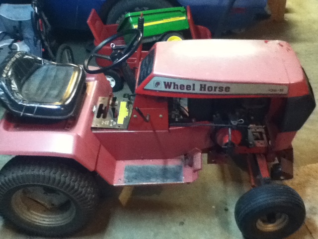

Here are some pictures of my 308-8. I started to take it apart then took pictures. I removed the deck to have a rust hole repaired then found more split metal at the mounting bracket bolt holes. Planning on a light resto just to repair problems and make it a problem free tractor. I have a few parts on order to correct items I found.

:WRS: I'm about 45 minutes from you in Mill Hall, Clinton County. If you need anything, this is the place to be. I have a 310-8 that is the exact same tractor as yours with just a 2 HP bigger engine. It is my main go-to everyday tractor. Feel free to PM me if you have a question though it's best to share any question with the whole group here. The talent and wisdom of many people here will iron out any issues you may have going forward!

I appreciate the info and help. I got the previous owner to talk to his family member who welds and will fix this deck up for me. I will put on new blades and was thinking of having the underside powdercoated to protect it. I'm sure it would chip off eventually, another thought was Eastwood's chassis black or something like that. I will use this to mow my rental properties if I need to and mainly to do yard work towing a lawn cart or tools around my property.
