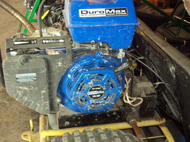

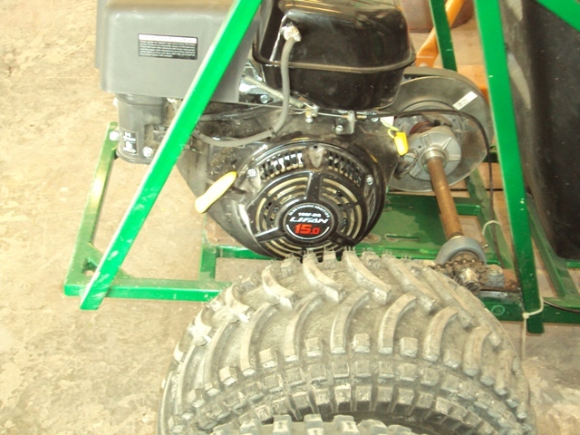

bowtiebutler956 650 #4 Posted May 28, 2012 We am running two of these 420cc clones on our off road buggies, and their great! One is a Home Depot 15hp non-electric start $250, the other is a DuroMax 16hp from Max Tool Online $290 with electric start. Those prices both include shipping. I opened up both of them and removed their governor gears before I ever started them, and added open headers. These little motors can take a lickin and keep on ticken! Matt :flags-texas: Share this post Link to post Share on other sites
