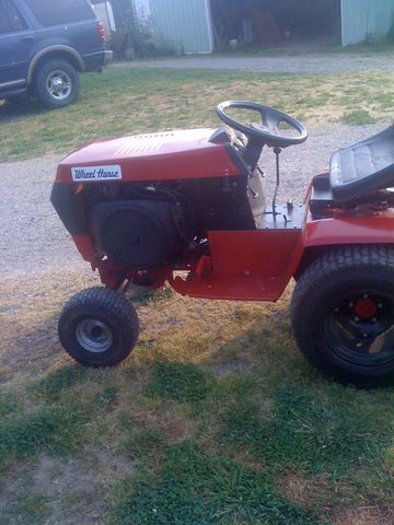

Callen 64 #1 Posted May 26, 2012 Is the oil too thin? I haven't changed it yet, just got it running. No oil coming out of the cc breather. Not over full. First time I've ever seen a vent on the pulse side of one of these type pumps, there is usually a vent on the other side of the diaphram. It's an '88 or '89 520H. TIA Chester Share this post Link to post Share on other sites

Callen 64 #5 Posted May 27, 2012 Oil runs straight down the shroud from the fuel pump. I just took it apart and replaced the pulse line because I thought that is where it was coming from. can't get a good pic of it. It will leave a puddle if i let it set and idle for a few minutes. Share this post Link to post Share on other sites

Callen 64 #7 Posted May 28, 2012 I bought it with issues. Cleaning the carb fixed that problem. Then I got a nostart condition. Cleaning the pin connecter fixed that. Now the oil leak. I wonder if the crank case breather is working. The RPM and load doesn't seem to make any difference on the leak. The vent in the pump still bothers me because it can draw dirt through the pulse line right into the crank case. It does run good, just a little black smoke on throttle up. Share this post Link to post Share on other sites

Callen 64 #11 Posted May 28, 2012 it's a 1/16 hole in the back of the pump, toward the shroud. This engine was replaced at 700 hrs, I'll have to pull a head cover and count the head bolts, The breather looks to be a 224, no breather in a tin cover, the breather sets right in the block. Share this post Link to post Share on other sites
