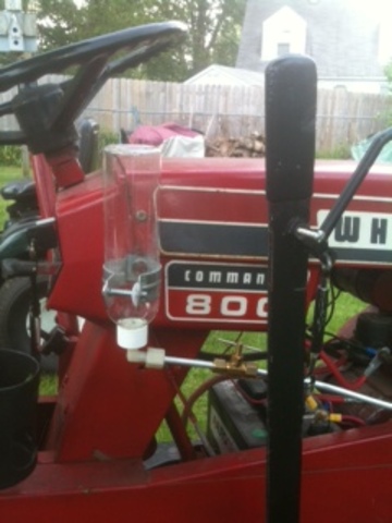

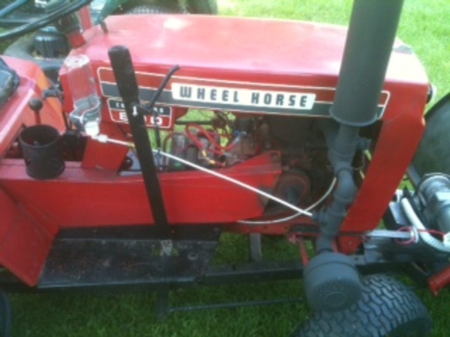

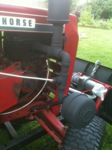

COMMANDO1 23 #1 Posted May 21, 2012 WELL ITS THAT TIME OF YEAR AGAIN, WITH MY PREVIOUS BUG FOGGER I HAD TO REMOVE THE EXHAUST STACK AND INSTALL. THIS YEAR I RE DESIGNED IT, LEFT THE STACK ON AND PLUGED IT, SO COME FALL ALL I HAVE TO DO IS UNSCREW THE EXTENTION AND PLUG. ALWAYS TRING TO MAKE THINGS EASY. I ALSO MADE THE CONTAINER SMALLER......HAD THE PASSER BY'S JEALOUS 1 Share this post Link to post Share on other sites

COMMANDO1 23 #4 Posted May 21, 2012 YES MOSQUITOES.....OPEN VALVE SLIGHTLY AND FOGGER LIQUID DRIP INTO MUFFLER...ILL GET PICS OF IT WORKING 1 Share this post Link to post Share on other sites
bowtiebutler956 650 #5 Posted May 21, 2012 I've had a very similar setup I've used on many different machines over the years. I use an electric fuel pump, and a small twist valve to inject it into the exhaust. I use malathion mixed into diesel fuel as the carrier. Works Great! Matt :flags-texas: Share this post Link to post Share on other sites

COMMANDO1 23 #9 Posted May 22, 2012 AS YOU CAN SEE MINE EXITS VERY CLOSE TO THE GROUND, I ONLY FOG WHEN THERE IS NO WIND. Share this post Link to post Share on other sites
