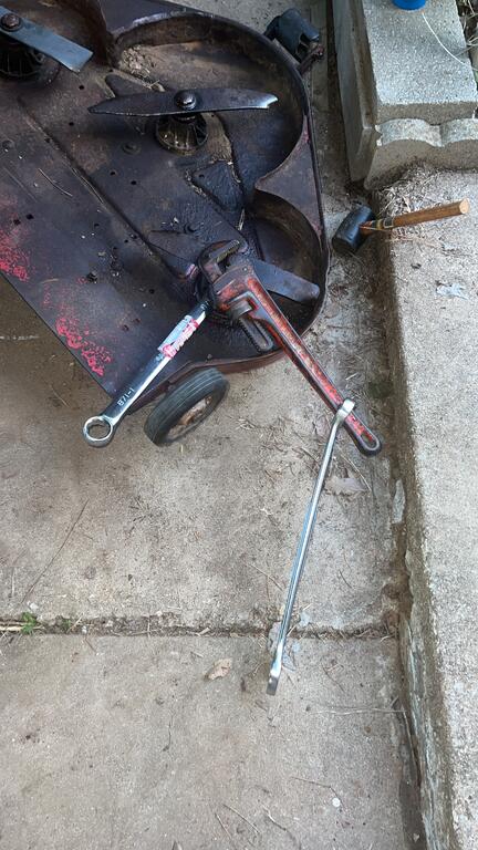

Wes P 2 #51 Posted June 9, 2023 How do I get a wrench that will work? Do I just need to buy a 1 1/8" Box End/Open End wrench and grind it down to fit? Share this post Link to post Share on other sites
8ntruck 9,301 #52 Posted June 10, 2023 I've been able to get by with a pipe wrench on the spindle hex. Reading through this post, I'm thinking I need to get 1 1/8 wrench and grinding it thinner. Probably will keep a bucket of water handy to dunk the end of the wrench being ground frequently to preserve the temper. If I get a combo wrench, I will be able to use the box end on the mule drive nut - instead of borrowing the table saw arbor wrench. 2 Share this post Link to post Share on other sites

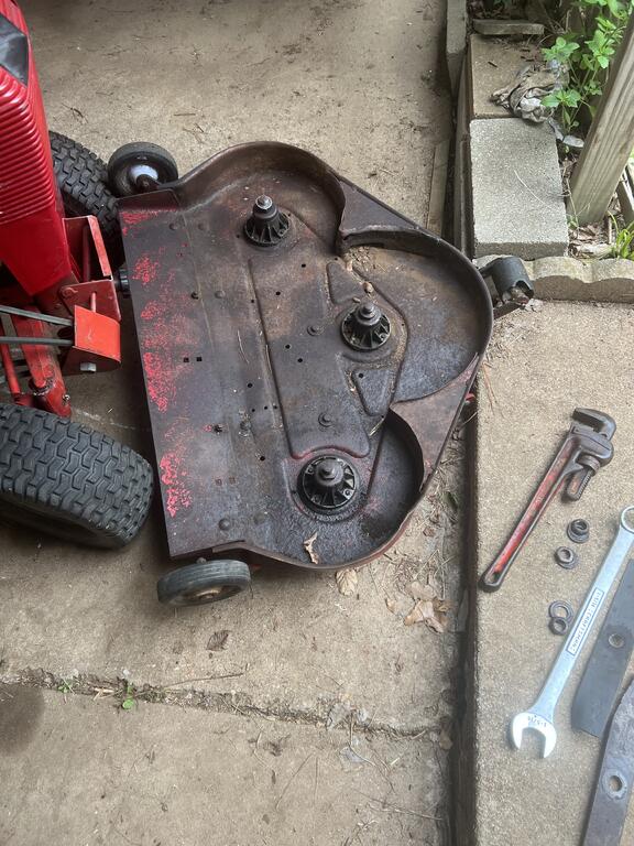

Wes P 2 #53 Posted June 10, 2023 I would guess I am applying 350 lbs of torque and the nut is not moving! Share this post Link to post Share on other sites
Wes P 2 #54 Posted June 10, 2023 I have sprayed the nut with Liquid Wrench 3 nights in a row! By looking at the blades, I would guess the deck has not been serviced for at least 12 years... Share this post Link to post Share on other sites
8ntruck 9,301 #55 Posted June 10, 2023 Impact is your friend. 3 lb hammer on the end of the pipe wrench. Also might try tightening the nut before loosening - repeatedly. Keep soaking with penetrating oil. Apply some heat to the nut. Don't give up. It took 12 years to set up. It is not going to break loose quickly. 1 Share this post Link to post Share on other sites
Wes P 2 #56 Posted June 10, 2023 Really good advise 8ntruck! Impact will not work, the nuts are worn down to where the 1 1/8 socket will not bite. I didn't think to tighten then loosen! I will give it another go tomorrow! Share this post Link to post Share on other sites
lynnmor 9,040 #57 Posted June 10, 2023 You may need to split the nut with a Dremel or similar grinder. Maybe an auto parts store could loan you a nut splitter but I don't know if you can find one that large. Share this post Link to post Share on other sites
Wes P 2 #58 Posted June 10, 2023 Good suggestion! The Jam Nuts are available through eBay, Part No 9150904, I ordered 6. I will have them by next Wednesday. I will try one more time today, if it doesn't work I will try the nut splitter.. Thanks for your help! Share this post Link to post Share on other sites
Wes P 2 #59 Posted June 10, 2023 The Jam Nuts broke free this morning! I guess they just needed one more night of soaking in Liquid Wrench. The threads were wet when they came off! The Wheel Horse Blade Box brings back old memories! Thank you all for your kind help! 1 Share this post Link to post Share on other sites
