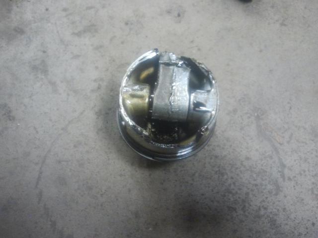

bprotiva 0 #1 Posted May 9, 2012 hi, new to this forum, and i just aquired a WH d160, and once i got it home, got it started up, i noticed the left bank wasnt firing. it has the 18hp onan, so after a few trouble shoots, i took the head off and discovered that the rod has snapped. ive been digging around on the internet, and have realized that rebuilding this is going to be a little costly. on onans site, a complete overhaul kit is $1100... so my question is do any of you know of any other sites that might have some of these kits or parts cheaper than that? or know where i might be able to just find another motor to just swap with??? thank you Share this post Link to post Share on other sites

bprotiva 0 #4 Posted May 9, 2012 this is what i found Share this post Link to post Share on other sites

bowtiebutler956 650 #7 Posted May 10, 2012 :WRS: Wow, when that rod let go, it really let GO! I don't know of any cheap place for onan parts, but I sure they could be found on . Matt :flags-texas: Share this post Link to post Share on other sites
1maidenfan 202 #8 Posted May 12, 2012 this is what i found If the piston is over sized it should be stamped on the top of the piston. Share this post Link to post Share on other sites
