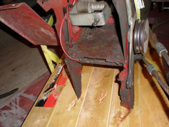

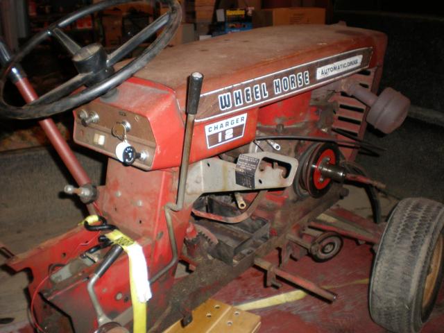

Pollack Pete 2,273 #1 Posted May 4, 2012 And I mean really broken.Like broken in half.A woman called me a couple months ago and told me of her fathers Wheel Horse that had broken in half.I went and looked at it and made her an offer and came home that night with the rear end,etc.Last night I went and got the rest.Anyone here ever see a frame break like this? Besides welding the pieces back on or changing the frame,anyone have a good repair procedure?The best part of the whole deal was the WH sales brochures that she gave me with the tractor. Share this post Link to post Share on other sites
Anglo Traction 761 #2 Posted May 4, 2012 Ouch !!. is that a clean metal break, or caused by rust rot?..... in fact looking at the Strengthening Plate on the Left , it doesn't look like it was originally welded and came apart, tearing the Right hand side. Oh, I would re-build it around a replacement Frame. Share this post Link to post Share on other sites

fourwheels0 191 #4 Posted May 4, 2012 tear it completely down to the bare frame then sandblast and re-weld it correctly. does it look like the left side was never welded?. Share this post Link to post Share on other sites
Pollack Pete 2,273 #5 Posted May 4, 2012 tear it completely down to the bare frame then sandblast and re-weld it correctly. does it look like the left side was never welded?. Nope.......looks like the left side was never welded.Musta been a Monday or Friday tractor.Maybe I can get it fixed under waranty.Not bad,lasted 40 yrs with only one side welded.Should last 80 yrs once it's repaired. :ychain: 1 Share this post Link to post Share on other sites

can whlvr 994 #7 Posted May 5, 2012 i would weld a thicker plate in,lots of wheelhorses do break there but seldom actually break in half,i have had lots of horses that needed repairs to that area Share this post Link to post Share on other sites
KC9KAS 4,744 #8 Posted May 5, 2012 Personally, I would start with a different frame, paint the frame and put the parts back on with fresh paint. You get the tractor put back together and a new paint job! Share this post Link to post Share on other sites
