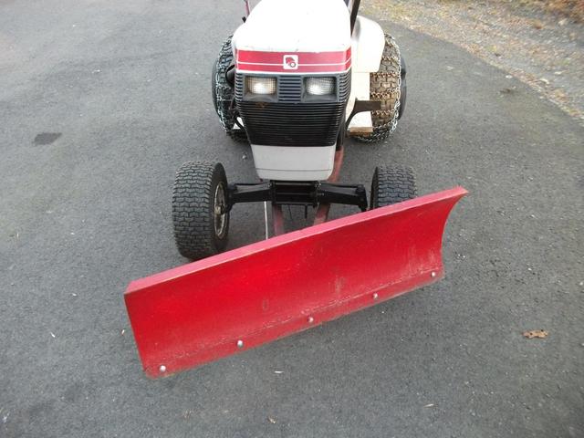

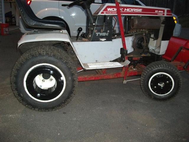

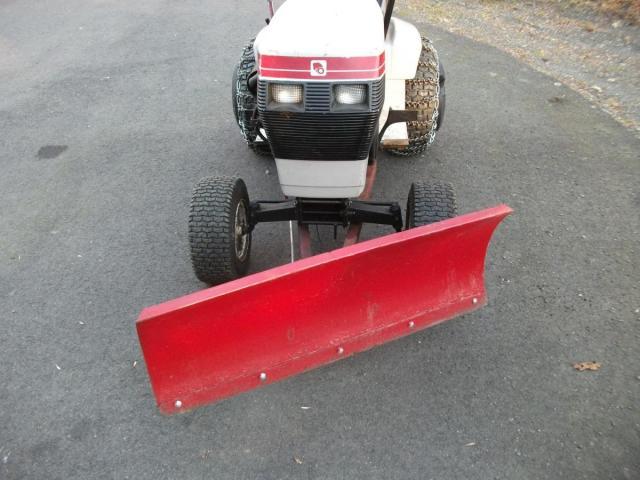

Sparky-(Admin) 26,359 #29 Posted May 6, 2012 So I got off my lazy butt and went out to the garage. You can see the model# decal in the side shot of mine just under the twin decal. Mine is a A116B801 which makes it a 1984. The paint is original on mine so the 84's were grey and not pewter. Mike................ Share this post Link to post Share on other sites
TT-(Moderator) 1,173 #30 Posted May 6, 2012 The standard color on all three years of WorkHorse LT & GT models was indeed called pewter. The majority of the 1982 models were pewter metallic - which has a goldish-green look when directly compared to the 1983/84 non-metallic pewter ~ which looks like more of a light gray. Just another clue to help ID these: Most 1982 models do not have the rubber hood latches. Models (product numbers) ending with "00" are all 1984's & were sold as the bare tractor. 1982/83 models were sold with the mower deck and the last two digits of the (product) number represent the original deck width of cut. (37, 42, 48, etc.) Share this post Link to post Share on other sites
