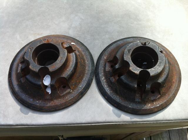

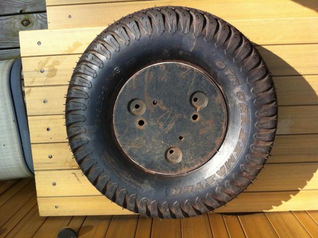

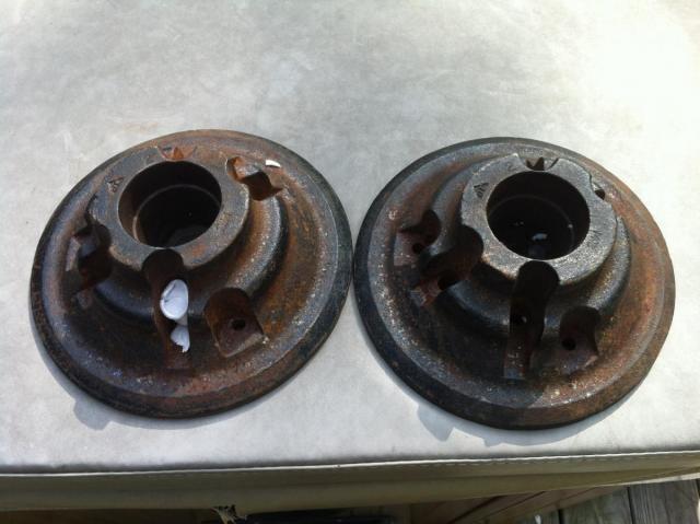

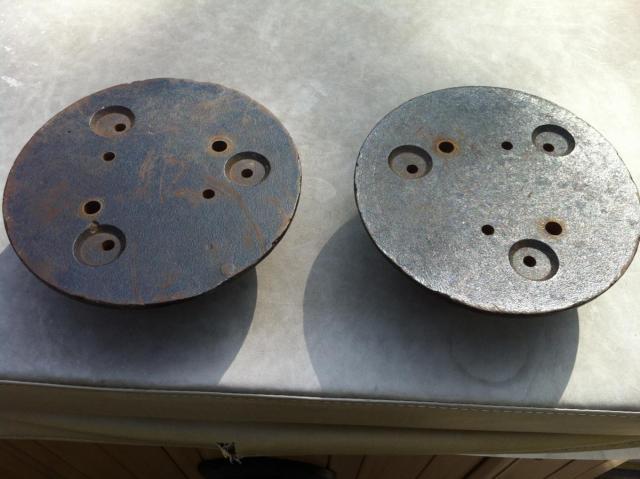

Hodge71 691 #1 Posted May 3, 2012 SCORE 1 FOR ME!!! I have no idea what theyre from and neither did the guy I bought them from but I can tell you they fit my 18 auto front rims. All I'm going to do is either chuck them up in the lathe or find the proper size holesaw and hog out the center so that you can gain access to the grease caps for the front axle. They were on and they went off before I read my watched item warning. There were no bids on them so I contacted the guy and asked him if hed do $35 with shipping which was his opening bid. He told me $45 with shipping so here they are. They weigh 27 pounds apeice and all they need is the centers hogged out and Valspar IH red paint. Anybody have any idea what kind of tractor they came from? Share this post Link to post Share on other sites
Kelly 1,037 #2 Posted May 3, 2012 Those are MTD, they fit the rears on mowers with 8" rims or fronts with 8" rims, they fit the deep front rims but will not fit the older narrow rims, you got a good deal, I've sold many of them for $75 a set, in fact I have 3 sets right now. I've never cut the ceters on mine I used a set for a few years on a older 520 with a blower, oh they will not fit the 520 with the forwad swept axle the rim hub is to big. Share this post Link to post Share on other sites

CRE1992 143 #9 Posted May 5, 2012 Would you be able to flip the rim around so that the grease zerk is on the inside? or is the spacing different? Either way it looks good! Congrats on the good find.Then it might save you a trip to the lathe, or drill press. Also I know where to get another set of those brand new for cheap if your interested. -Charles Share this post Link to post Share on other sites
AMC RULES 37,254 #10 Posted May 5, 2012 Another nice score Jeff. Isn't hogging out the centers going to remove much of the weight you're trying to add? I'm just sayin'. :dunno: Share this post Link to post Share on other sites
Sparky-(Admin) 24,647 #11 Posted May 5, 2012 Didnt you look at the pictures Craig ? In the pics showing the back of the weights the center is allready hollow so only a thin layer would need to be removed from the face of the weight. The set I have (same exact weights) had the center removed. Mike........ Share this post Link to post Share on other sites
AMC RULES 37,254 #12 Posted May 5, 2012 Indeed I did look...the outside, faceplate of that weight looks to be about 1/2 to 3/4" thick, and probably 3" in diameter will be removed, correct? I'm thinking a 27# weight will turn into a 25# weight, all said and done. Did you weigh your's after the modification Mike? :scratchead: Share this post Link to post Share on other sites
Sparky-(Admin) 24,647 #13 Posted May 5, 2012 Mine came on a WH and were all ready modified so I dont know the before and after weight. The center hole is about 1.5" - 2" on mine and I dont think its anywhere near 2lbs of material removed. And if it was 2lbs per weight you would never notice it while using them on a tractor. Mike.............. Share this post Link to post Share on other sites
