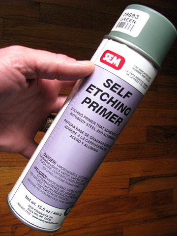

AMC RULES 37,235 #4 Posted April 29, 2012 :confusion-shrug: Share this post Link to post Share on other sites
bowtiebutler956 650 #5 Posted April 29, 2012 Craig, I hadn't even considered using a rattle can, but I guess I could. Still think I would be better off with something I could use my gun with. I bet I could buy that by the quart as well. I'll have to check the price. Craig. Matt :flags-texas: Share this post Link to post Share on other sites
