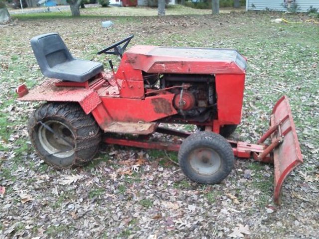

ushoundog 0 #1 Posted April 9, 2012 i need any info i can get on this tractor it has a hydro lift and drive twin cyl onan i want to restore runs great got it for free Share this post Link to post Share on other sites
whtractors24 3,441 #2 Posted April 9, 2012 Looks like I think to be a c-125 12 hp Kohler motor hydro rear end. Rear fender is home made. Share this post Link to post Share on other sites

WH854 45 #4 Posted April 9, 2012 i need any info i can get on this tractor it has a hydro lift and drive twin cyl onan i want to restore runs great got it for free I will take a shot at helping. It has what is called a black hood on it, which would make it a C series tractor, possible a C-165 Auto, I don't think the Onan was in the C series tractors.(Kohler And Briggs engines I could be wrong on this part) From the rear can you see an oil filter,on the left side. that would make it have an Eaton 1100 transmission.the fender pan looks like it was home made. OH YEAH look down under neath where the key switch is maybe there is a little tag with the model # Thats all for me Chas PS :WRS: Share this post Link to post Share on other sites

whfan74 2,073 #6 Posted April 9, 2012 If it is an Onan, that would be a transplant to that machine. My guess is that it started it's life as a C-161 Twin Automatic. Like the guys mentioned.......check for the tag and we can go from there. Welcome to the Square! Share this post Link to post Share on other sites

liketoplayto 6 #9 Posted April 9, 2012 could be a c175 twin engine but that been a kohler engine i believe 17 hp Share this post Link to post Share on other sites
leeave96 490 #10 Posted April 9, 2012 I'm thinking a C-165 too. I think (real fuzzy on this one) they may have used a twin cylinder briggs in those tractors too. The good news is it runs. I like the home made treadplate rear fender, just watch your leg on those sharp corners! Good luck, Bill Share this post Link to post Share on other sites

jdog_kustoms 82 #13 Posted April 9, 2012 a d series is a totally differant tractor its a lot bigger it probelly was a c-161 with a twin briggs in it that went bad and someone put a onan in it here is a link to what the d will look like Share this post Link to post Share on other sites

Kelly 1,033 #15 Posted April 9, 2012 I can say for sure it's NOT a C-161, they had fiberglass hoods and a different dash, they never put Onans in that body from the factory, it is from 1980 to a 84, it's a hydro so that rules out the 8hp C-85 it could be a C-105, C-125, C-145, C-165, or a C-175 you will need to read the model no. off the tag to find out what year it was and what model it was. And as a side note, they used metal fenders in 84, so I would guess yours had plastic ones and they broke that is why the custom fender, so I'm guessing it not a 84, and it looks to have older or incorrect front rims they look narrow not the deep style that should be on it. Share this post Link to post Share on other sites
boovuc 1,090 #16 Posted April 9, 2012 That motor has the "shaker" cradle and it really looks like a KT17 Kohler Twin. I'm saying it's a C-175 Auto. 1 Share this post Link to post Share on other sites
Kelly 1,033 #17 Posted April 9, 2012 :text-yeahthat: I thought it looked like factory twin exh. on it, but he said it was for sure a Onan, so I stopped right there. Share this post Link to post Share on other sites

ushoundog 0 #21 Posted April 10, 2012 ok so first i need to appologize it is a kholer Share this post Link to post Share on other sites
ushoundog 0 #22 Posted April 10, 2012 i hope to restore it when im not using it here are some more pictures the story behind the tractor is it was baught by the company i work for as a grounds tractor and sadly they where going to scrap it so i said i would take it they said ok brought it home and it started right up Share this post Link to post Share on other sites
jdog_kustoms 82 #23 Posted April 10, 2012 if its a kohler then it is a c 175 Share this post Link to post Share on other sites
