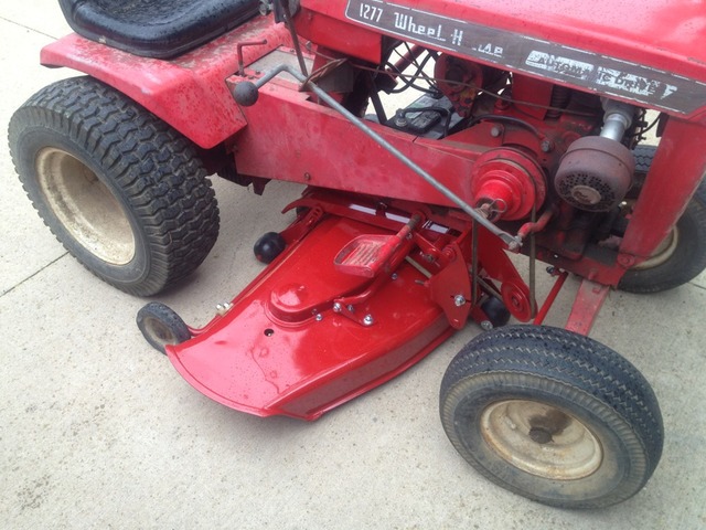

The toymaker 22 #1 Posted April 7, 2012 I mounted my 42" sd deck under the 1077 and I think there must be a spring on the pto belt tensioner. maybe up to the frame or foot rest shaft. Could someone please help by taking a picture or two of that area. Thanks Share this post Link to post Share on other sites
autoxman 3 #2 Posted April 29, 2012 If you are using a period mower on your 1077 there are no springs used, just a bolt to tension the belt using a pully. Check this diagram: Check the bottom right part of the diagram and see if you have all of the parts shown. Mark Share this post Link to post Share on other sites
Martin 2,134 #3 Posted April 29, 2012 Here's a pic of the setup on my 1277. If you need a close up I will get one tomorrow. Sent from my iPhone using Tapatalk Share this post Link to post Share on other sites
Martin 2,134 #4 Posted April 29, 2012 heres some more close ups....... that belt i near the end of its life......we will see how long it lasts... Share this post Link to post Share on other sites
