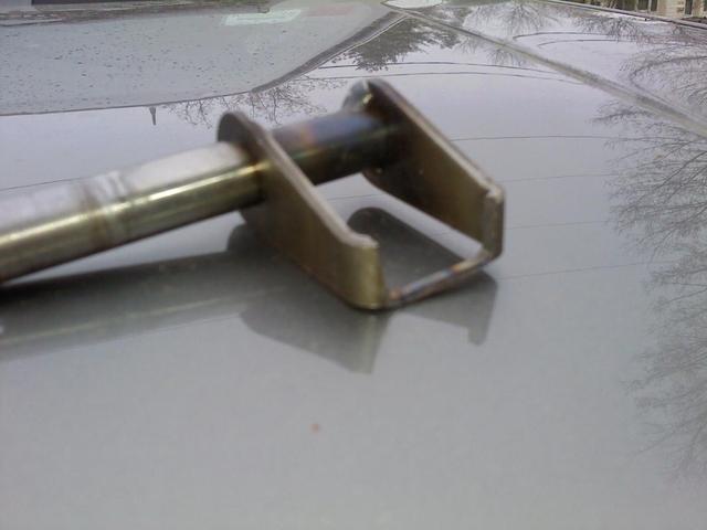

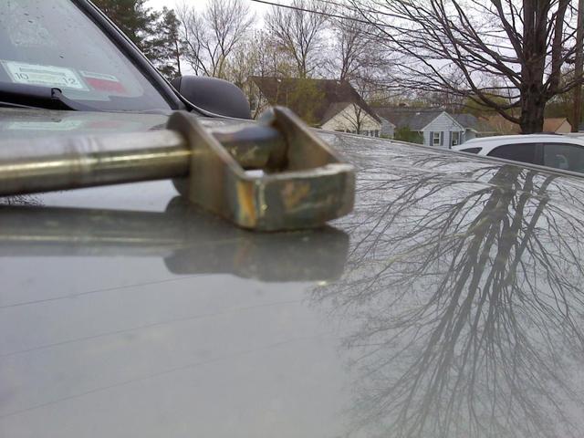

HorseWhisperer 243 #19 Posted April 21, 2012 This is why you have no parking brake.I just tore down my electro 12 today and repaired the Achilles heel of old wh hydros.Stupid Pawl Share this post Link to post Share on other sites
HorseWhisperer 243 #21 Posted April 21, 2012 Before and after.don't panic and pull the e brake.Your still gonna hit what you didn't want to and you get a bonus " break"! Share this post Link to post Share on other sites
meadowfield 2,931 #22 Posted April 22, 2012 looks just like mine did! (the pawl). The tractor has to be stationary, before engaging the brake.... 1 Share this post Link to post Share on other sites
